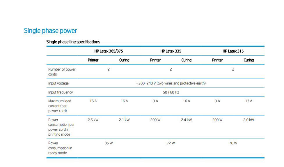

The power specification in the site prep guide references 220v power, with +/- 20v. In the event that the input voltage is outside of this range, a buck boost transformer is required. The specs for the transformer are as follows:
1-phase buck boost step-up transformer 240V primary – 208 secondary at 26.6 Amps – 50/60Hz

It would be preferable that all input voltages are within the specification defined in the site prep guide.- see attached.

That's not 5v over its 25v over. The machines is designed to run 220v with a tolerance of 20v due to the variances in service voltages (208, 215, 220, 230, 240v) across their install base.
