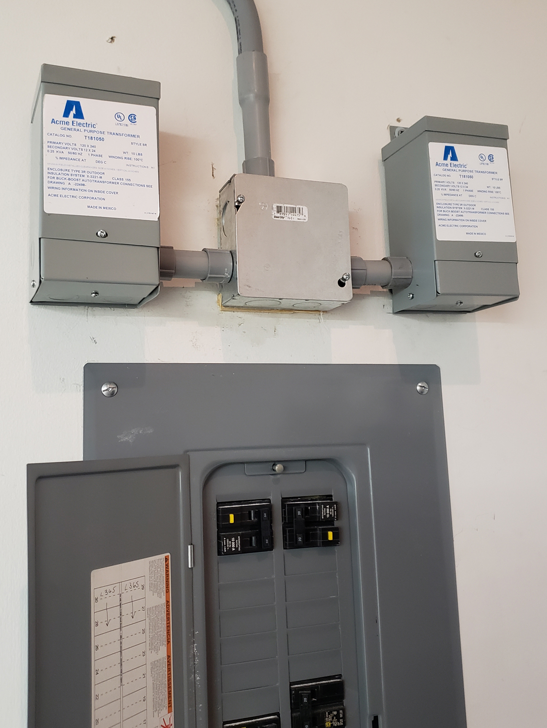

So we talked to the electrician again and mentioned things the techs and hp said. He (electrician) asked me if i could ask any of you who have one of these and have used a buck booster or transformer to step down the voltage for one of these printers where it is at in the circuit. In other words...
a) The 2 cgfi breakers in the main panel, feeding buck boosters, then the outlets.
b) Larger breaker in main panel feeding the buck booster, then from buck booster to a sub panel with the 2 gfci breakers in them, then the outlets.
I have a new L365 and had to install buck/boost transformers to meet HP's site prep specs. There is one on each circuit, and they are installed AFTER the breakers, and BEFORE the outlets (see photo).
My electrician, though very experienced, had never installed buck/boost transformers before, so he called the manufacturer to get some clarification, and also consulted with another veteran electrician.
I have had no problems so far with the circuits or the printer.

it's interesting, i don't question that that is the info the manufacturer gave you, but the buck boost transformers interfere with the protection circuits in the breakers. that is why the electrician asked for clarification
