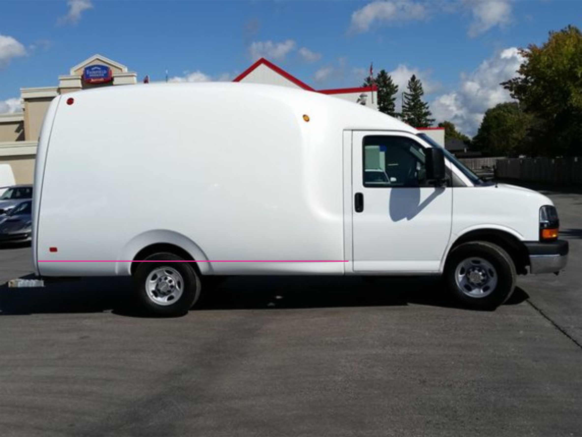

Just curious what you would do with one of thee vehicles as far as applying the graphics
There is no references at all for making anything straight to the body... Use a level? Measure from the floor up?
Maybe a T-square out from the door jam and go up and down from that. Tough call. Too many rounded areas to be accurate.
Billct2
After looking at it again, we'd probably run a laser level off the crease at the bottom of the door.
