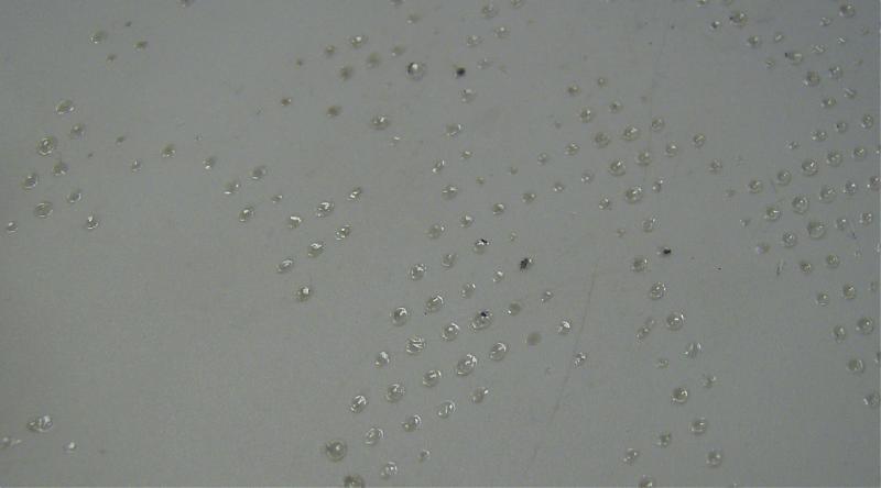

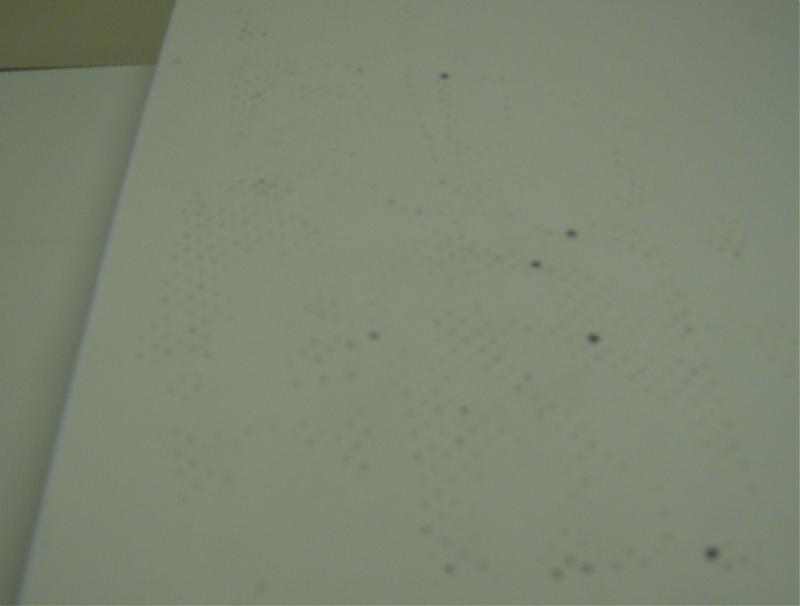

Can anyone guess what caused THIS??
jiarby
On the top covers on a mutoh ValueJet 1604, now nicely pitted with dimples.
These are the two covers on each end of the printer (above the capping station, and the maint. station)
You'll never believe what caused it....

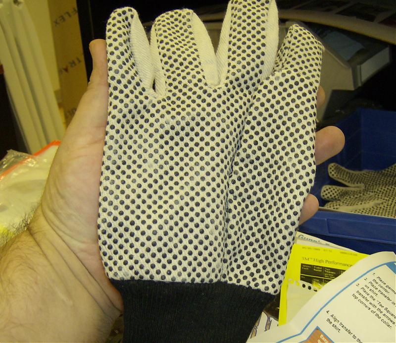

OK...
Here is the answer...
I bought some gloves with little grippy dots to use when changing material so we could keep greasy handprints off the media.
After installing the roll I took the gloves off and set them on top of the printer so I would remember to use them.
The rubber dots dissolved the ABS plastic lids. (or vice versa). I thought the dots has just stuck to the top, but it has actually pitted the top of the printer.
No heat, no solvent. Just took the gloves off and set on top. The next morning they were stuck.

I have those gloves too, but I wear them backwards because the black dot grippers mark up the vinyl worse than my hands.

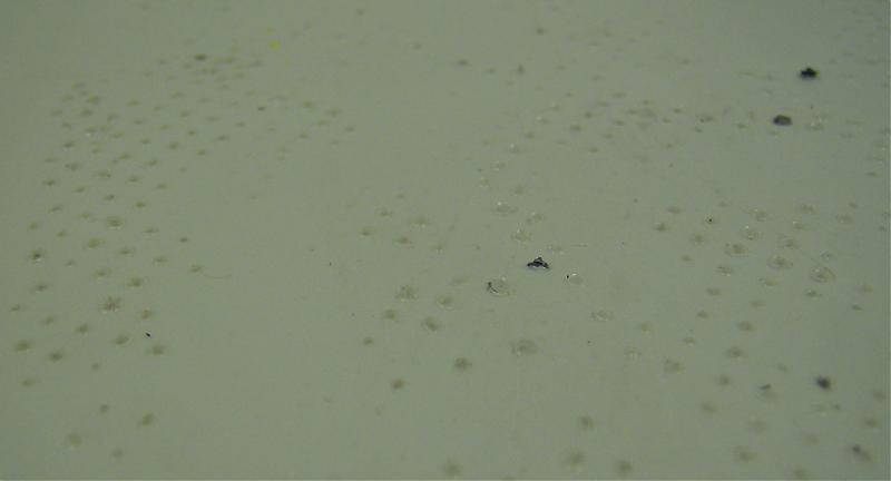

here's a clearer picture...
