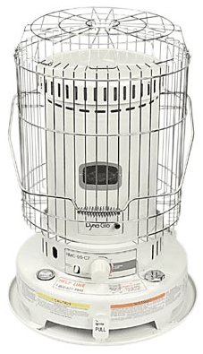

By the way, I'm thinking radiant heater....not a torpedo heater. Torpedo is too loud and annoying for me.
weaselboogie
pat. that is the heater I tested. It was not good because of the fumes and soot.
I have one of those 22,000 btu heaters also. You need to baby sit them. If they get a charcoal buildup on the wick they will blow out soot like crazy. ( Ruined my freshly painted garage ) . Since then, I run it at about 75% instead of the full wick and it has been great since. They take a bit of adjusting , but work ok as long as you're not too far away from them.

I hate the heater you pictured because in my experience, they really stink.

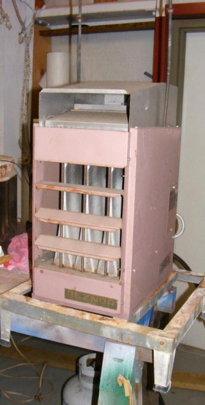

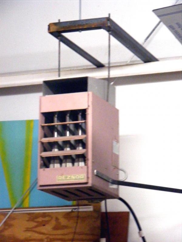

I have a natural-gas sucking ancient REZNOR from a department store, can't afford to use it.
