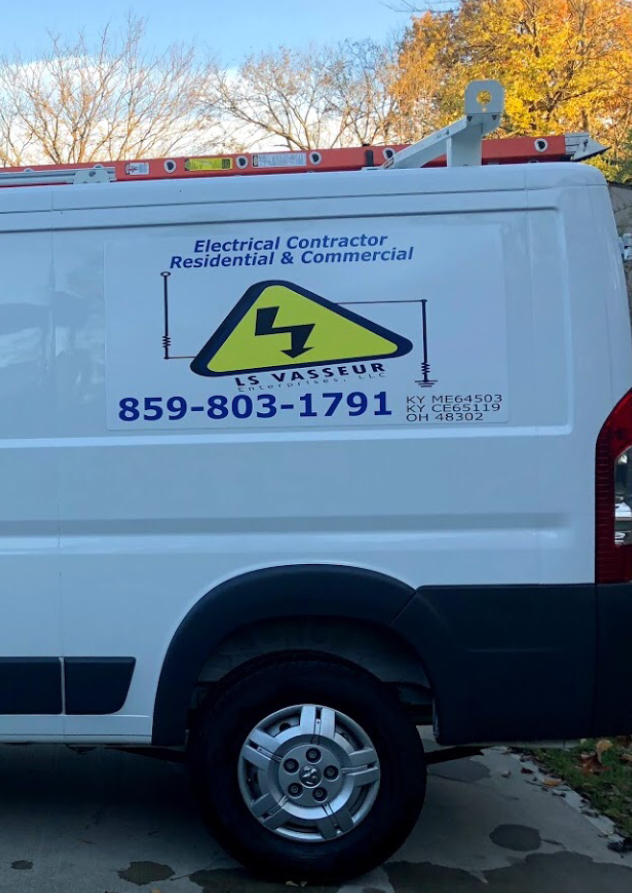

we have a spike in customer complaints about car magnets falling off the cars. Can’t pin point any other specific reason but cold temperatures ? Customers who complain the most tend to insists that they frequently remove and clean the magnets / car surface / follow all the care specs - that may actually add to the issue (freezing)?

Magnum magnetic 30mil with laminated ij35 print on a newer dodge promaster cargo van:
“...Order xxxxx Purchased 10/31/18 Cleaned and prepped surfaces after 2 weeks the left side fell off! Sitting in the driveway, just fell off! Cleaned both surfaces and re applied, again after short but it fell off, and now the other side fell off while I was driving down the road. Terrible product”

We also try to steer customer's away from magnet as much as possible. With that being said we've found it beneficial to use wrap material instead of intermediate for the same reasons mentioned above. Always round corners and also tell our customers that in cold weather the magnets WILL fail and/or wreck their paint jobs. The reality is that even though customers say they are ensuring a completely clean surface on both the magnet and the door, the majority of the time customers are just slapping them on without a care in the world. We live in a climate that is colder for 5-6 months. The cold weather makes the material more rigid and brittle and particularly at higher speeds the wind will grab them. We also generally make our magnets 12" x 24" and wouldn't attempt to do them at the scale posted in the sample image.

Looking at the photo of those mags the issue is obvious, the design has a connection to ground.
