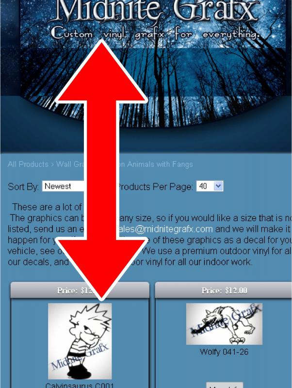

Really? Peeing Calvins? You do realize that automatically makes you the laughing stock of the industry, don't you?
