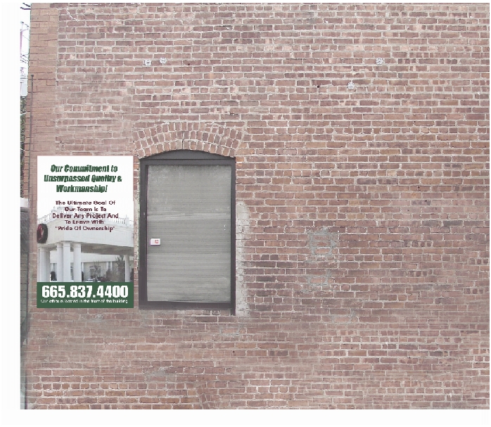

My customer is interested in a changeable ad sign to be installed onto his exterior brick wall as shown.
I am looking to produce a cost effective way to manufacture this type of sign.
He would like the sign to be rigid and not a banner of any kind. I was thinking of mounting a sub panel manufactured from di bond, and overlaying it with a digitally printed piece of styrene. I'm not really sure how to install this overlay without using visible fasteners?
I would appreciate any alternate suggestions

Snap frames would work. Not sure what merchant members would have them. Mdi worldwide has standard sizes of 28x44 and 41x55. Fastchangeframes.com can make any size. We use them with .03 styrene.
SignManiac
Careful using thin pvc or styrene with any dark backgrounds. If the sign is exposed to direct sunlight, the heat can and will warp on you. you would be better off with aluminum or ACP as your substrate.
Billct2
We did bus sides with a wall mount extrusion that had one side removable, and coro for the panels.
