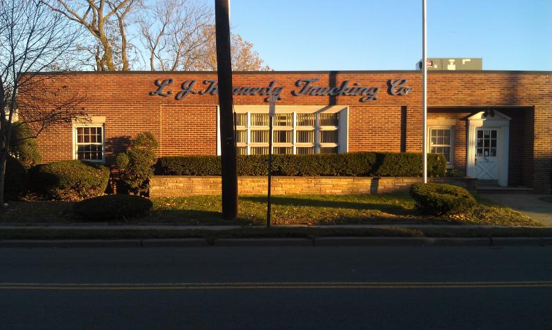

see pic letters are approx 20-26" high

Those look like old stainless steel reverse channel, do they have standoffs with neon.
They appear to just be stainless dimensional letters. I believe the term channel was just misused here. Probably like an inch or two deep with stud mounts cemented in the holes. They could also be hollow letters with long studs into the brick.
Still, no picnic to remove. It's not hard to do, just time consuming because of the many angles you have to contort to.... to get to certain studs.

wow cool old letters. I could snatch those down in about 30 minutes with bucket truck maybe an hour on ladder. Prybar should do the trick but I would damn sure get paid for it at least $250.00 for removal
Billct2
Yea, those are some nice letters. Should be an easy removal. Probably reverse channel with studs usually installed with an offset. Gentle work with a prybar.
