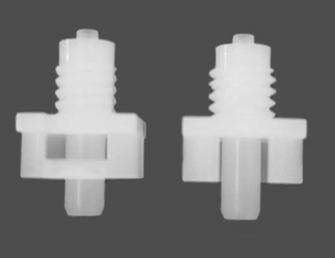

Agreed. For a comparison of simplicity vs engineering complication, look at the DX7 ink line to damper connection of Mutoh vs Roland. I absolutely detest the Mutoh part. I'm starting to suggest my Mutoh customers switch to the Roland version during a head replacement. Mutoh - stuff needed - needle nose pliers, new O-rings for ink line nut and patience for the PITA factor to remove it. Roland - stuff needed - finger and thumb, push ink line onto barb fitting, push adapter down on damper until it click locks. Squeeze click lock to remove. Easy peasey... Done...
Thank you. This helps me to decide on going with the Roland.
netsol
all very true
i keep a set of metric ignition wrenches by each machine.
i find you are much less likely to break one of those nipples the damper sits on if you can give a very gentle twist with the wrench
but probably the best money you will ever spend is getting a replacement manifold so it is no big deal if you do crack one of the fittings
