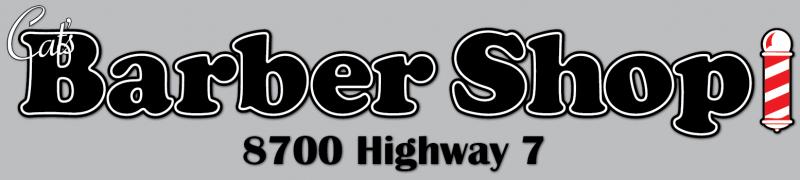

So,
This is my first design post although I guess its not really a design as much as basic font manipulation and a vector thrown in there.
I have a lot of ideas, however they get lost in translation somewhere between my head, hand and computer.
Would love to know what you think about each aspect of the overall thing. i.e kerning, layout size relative toward each other and that sort of thing.
I am really trying to learn as much as possible about layout but you all make it look too easy!
mountaingraphic
Sorry I forgot to mention the substrate. Had thoughts of an overlaid plywood painted however I do not have the order just trying to be proactive in sales.
OldPaint
cant find a better font??? what does that say in script on the B? i gather the sign is going a be a long thin one? take off the barber pole, put a bigger one on a separate panel......that font is so over used...... you printing or cutting this?
SignManiac
Get Cats off of the B for starters. I don't think you really need the road name on the sign. If a person is in front of the sign and can read it, they should probably know what the name of the road is there on? I think the Barber pole should be left of Barber Shop also.
mountaingraphic
Thanks, the back story to this is I originally had a similar design already completed however due to a hard drive failure I had to start from scratch. Also this is my ill attempt to learn illustrator vs draw.
The customer did have the requirements of the road name, not sure exactly why as I thought the same thing. If your reading the sign you should have a basic understanding of where you are.

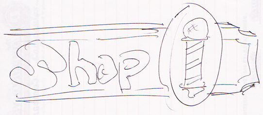

iSign
agree.. Cat's isn't working, maybe real small on top, centered between the ascender of the second "b" and the "S"
on the pole, I like OP's suggestion. Here's my take...

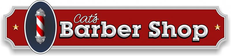

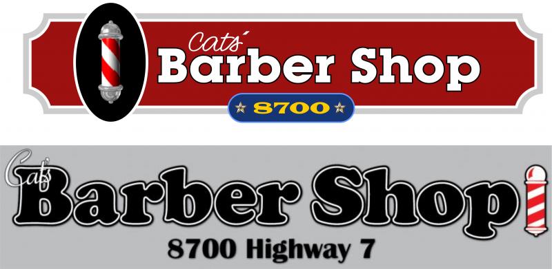

SignManiac
Upsell... Give them your cheap price, a custom price and a deluxe price.
Show it to her without the address so she can see how much cleaner it looks and mention Doug's idea about putting the number somewhere else on the building.

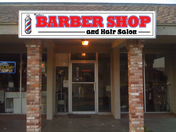

Redwave Signs
This is a design I had started for a customer, but he backed out. This is the first version, but maybe you can get some ideas.
