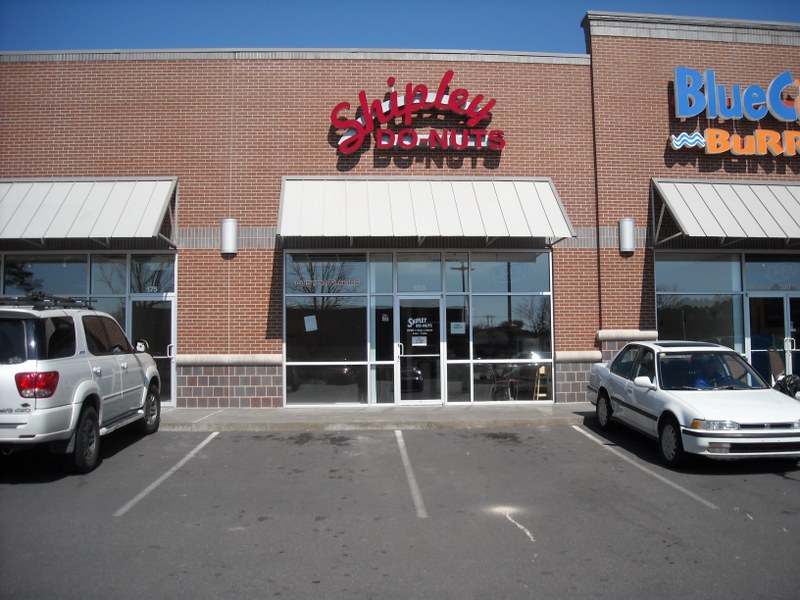

Anyone know of a supplier that does this?

Why are they white is what I'd really like to know.
Yeah tell me about it. Red on brick doesnt work too great either. While we were trying to help these people figure out how to correct their visibility issue, the folks next door came out and said "hey we want a sign like that". Our normal supplier for these has bailed on the curviness.

making a shaped/curved raceway is no diferent than making the shaped/curved letters as they are both made from aluminum. who ever does your channel letters should be able to do the raceway too.
red on the brick is OK if you make the cans and trim cap white. the raceway should be painted to blend in with the brick or paint it in a way that it becomes a design element.

Just goes to show that ugly channel letter signs happen just like ugly vinyl signs. It's just going to keep getting worse I fear. I hope one day they pass a worldwide law against ugly signs.

Sucks that our channel letter company is chickening out of this one. Very big PITA.
