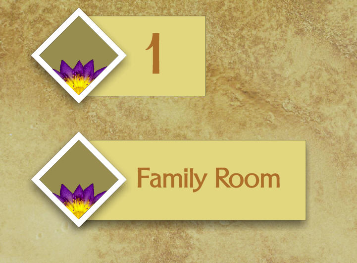

I'm doing some custom work for a hospice and they need wall hall signs. They need to be ADA compliant. I have a design worked up but need a source for the braille portion. Any suggestions at all???
I can do the logo on the left. I need a basic rectangle for the lettering and numbers with raised copy and the little braille dots below. Here's a what they will look like minus the dots shown here. The background cream color and letter colors and dot will most likely be custom colors.

The visual copy needs to be upper case...
you can do second surface graphics/paint on non-glare acrylic, raster braille and engraved copy.

I was going to say, the text needs to be all uppercase, and i'm not sure if that font is going to be compliant either.
SignManiac
Rick not sure I quite understand what that means. Do you have an example you can show me. Is this something I should be able to do myself or should I outsource the braille portion?
You also might wanna check and make sure you have enough contrast from background to letters/numbers colors. Sometimes no matter how appealing it can be made, it won't pass an ADA inspection.

Doesn't all text and numbers have to be raised and sans-serif?

On the color, if you are using a particular paint, you can get the LRV from the manufacturer to see if you are within the 70% contrast. The images you show might be pushing it.
On the type, the number "1" has that fancy little serif, some san serif typefaces have serifs on the numbers, it's a tough call, you can hack that thing off and there will be no issues.

I found the requirements for the fonts allowed. I'll change mine over, no big deal. Read up on the spacing requirements, etc. I'll make the few changes and it should still look okay when done.
