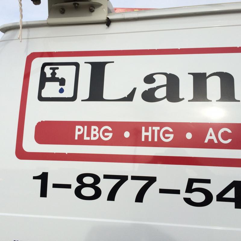

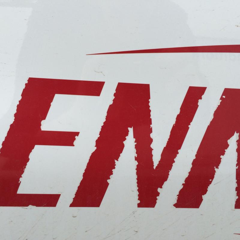

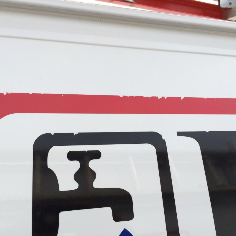

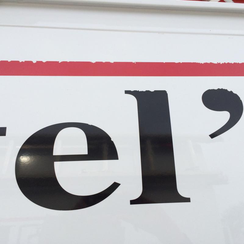

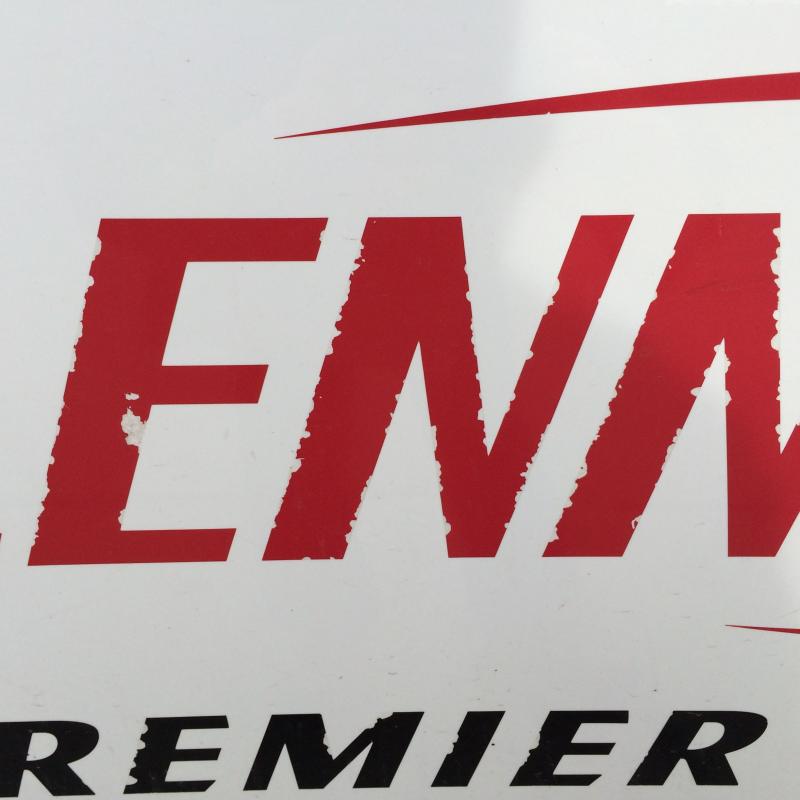

I have installed two vans for a client using cut vinyl. I used a 3M 7125/7175 series cast vinyl. The installation took place in fall of 2010 and both vehicles have the same problem of the edges coming off. I can still see the adhesive on the vehicle in which has attracted dirt. Can anyone tell me if they have seen this before, and what the cause actually is? I have talked to other installers who have been installing cut vinyl on vehicles for over 30 years, and none have seen this before. Anybody with any experience with this, I would like to know what you found out. I have other vehicles for this client in which were done 2 years before these were installed, and the vinyl still looks fantastic.

running it through a brush car wash? pressure washed maybe? the direction of the flaking looks like a horizontal action

Pressure washer. See it all the time. This has been posted about before several times.
Also, in fact recently watched an employee acting all pissed off because he had to wash the company vehicle. He was hitting edges of the vinyl with the spray and little flecks were flicking off as I watched..
Has nothing to do with install or how clean or anything like that.

The problem is mostly affecting the vertical edges of the vinyl, the horizontal edges are virtually unaffected. This would lead me to think that it has something to do with environmental conditions (washing etc.) rather than the vinyl itself.
