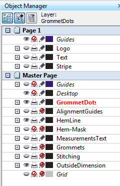

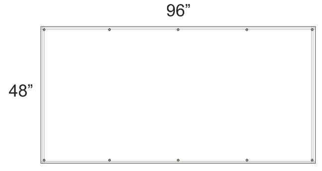

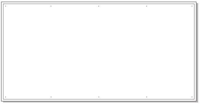

I have layered corel template files that I use for making banners.
Layers:
Grommets (for customer proof, does not print)
Grommet Dots (printed small dots that show where grommies go. No measuring!)
Stitching (for customer proof, does not print)
Hemline (where we fold to do the hem. Also is thhe finished dimension)
HemBleed (1" outside contour of Hemline... contains b/g color or image full bleed)
HemMask (a mask that obscures the area between the HemBleed & the Hemline. Used to take a screenshot to proof the banner so WYSISYG) Does not print
DimensionText (displays dimensional information for customer proof. Does not print)
These all go in Master Layers, then content goes in regular layers. Over the years I have accumulated practically every size so now it is easy. Just "open new file from template" then select the size banner I need, and plugin the content. Grommets are already laid out, stitching is there.. When it is proofing time I turn on the grommets, stitching, and hem mask layers and take a screen shot. When it is printing time I turn them off and turn on the grommet dots (they are smaller (.25), and color depends on b/g layer for contrast)
So, to answer your question... I would just use a straight edge ruler and a box knife to cut along one of my printed lines.
