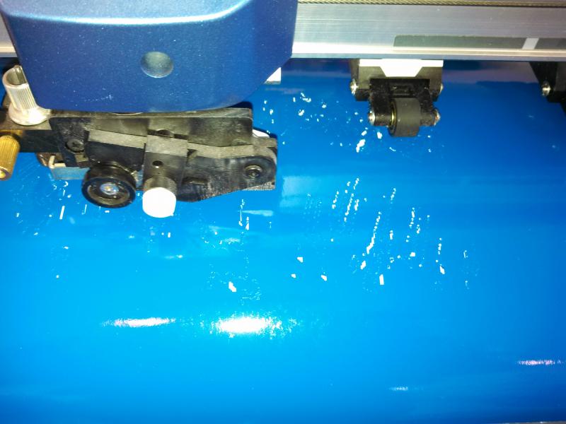

anyone have any tips or tricks to cutting small objects without the vinyl lifting i am having no luck with this i have my speed all the way up and that seems to help but not much.
roland gx500

Yeah, print it! Back when I did alot more cut stuff I would put in a new blade, less weight, and slower speed. Also sometime I would duplicate the object so it cut twice and then really used alot less weight.
What material, the 3M with the plastic liner works best for small stuff.
JUST PRINT IT!!!
petepaz
for me i have found the slow speed helps more. what size object/text are you trying to cut?
i have found we can't go much less then 3/8 to 1/2 on our roland. on my gerber plotter we can get to 1/4

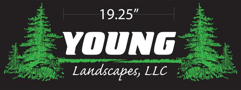

7125 I would love to print it but my customer wants it cut the last one we did was printed with a white offset around it and it looked pretty good and wasnt noticable from 10ft away but he said he would pay the extra 100 bucks to have it cut vinyl
SIGNTIME
here is whats being cut ....(note: logo supplied by customer and doesn't want to change it) the width of the L in "LLC" is 3/16 to help get a better perspective

How Big? It could be printed on clear; that's what I would do.
The slower the speed and sharper the blade, the better cutting it will do. However, a job like this would NEVER work out on our large format cutter, I would only be able to possibly get away with it on our smaller 15" plotter as it is much more precise on the start/stops.
That is a refusal type job. That is not meant to be die cut. That should either be hand painted or digitally printed.
The only secret/hint for that is to completely simplify all those cuts and dumb it down for weeding. Anyone doing that....... hasn't anything else going on.
SIGNTIME
are you trying to cut the branches on the trees ? i doubt that's going to happen
hahah yes :frustrated::banghead: .... We would normally just so no it has to be printed but the customer wants it cut badly and we told him we would do our best so thats why im trying to do this he is turning out to be a good customer and we just wrapped his trailer so we are willing to go the extra mile

If you absolutely have to cut it put a weed border through the middle and weed top half pulling up and bottom half pulling down.
max
what if you cut it but dont weed it. put transfer tape on entire unweeded graphic. install onto surface, then weed out the unwanted green around the branches on the tree. hope this made since
I thought it looked familiar.............. :doh:

thanks for the tips everyone i think ill be okay it cut okay on the test with the slower speed should go better with a fresh blade ... i wish i had a shark with fricken laser beams attached to its fricken head
Use a new 60 degree blade, with 3M Electrocut vinyl. I've cut, weeded and applied 1/10 inch high letters (8 point) using this combination.

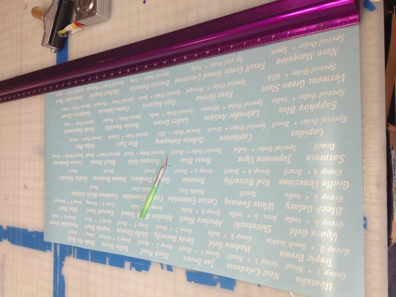

Did this one last week - 3.5 hours of weeding, and blade depth was spot on. Only pulled two letters too.
NEVER AGAIN.

If you can cut it, I recommend weeding the trees after you apply the vinyl to whatever surface, I assume doors, and yeah as mosh said, see if you can simplify the trees a bit.
