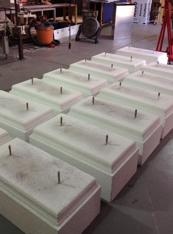

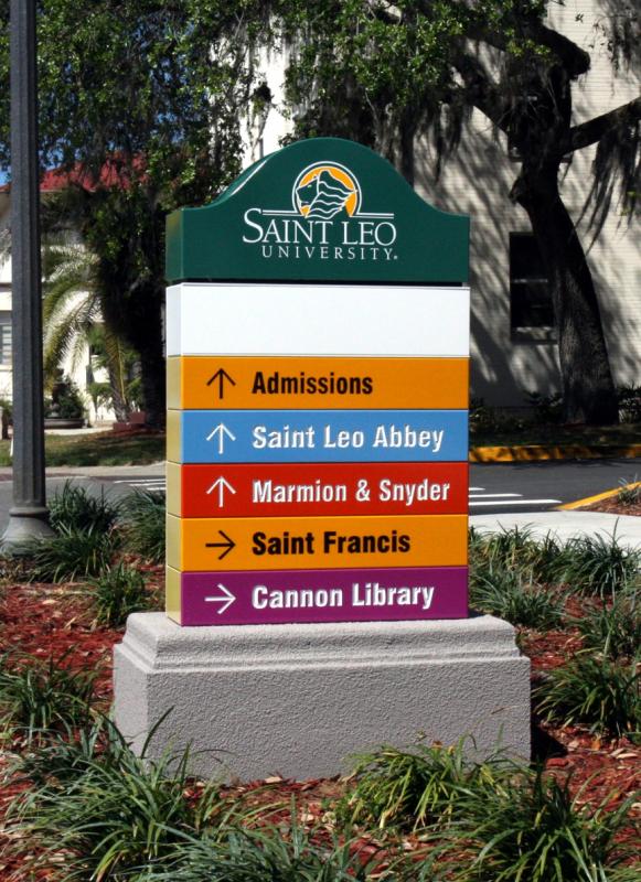

This is one of the most challenging projects I've taken on in all my years of sign making. Design, engineering and build. Fourteen signs total all weighing close to 1,000 lbs. each.

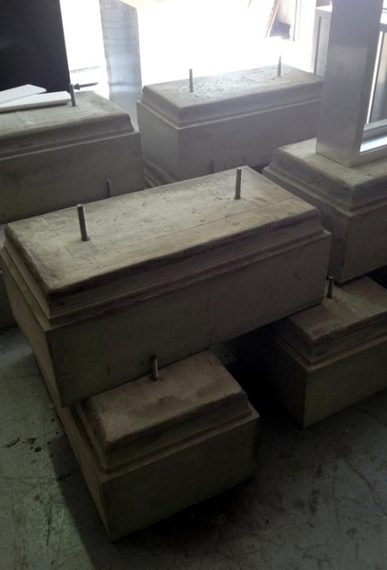

Started with the concrete pedestal bases. Built a dimensional mold and poured 800 lbs. of concrete in each one. Broke the mold apart after 24 hours of cure time and then started on the next one. Afterwards, I shot them all with acrylic stucco for the texture and then painted them all. Just moving these around in the shop was a challenge, lucky we have a forklift.

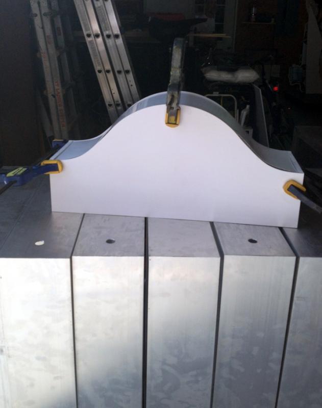

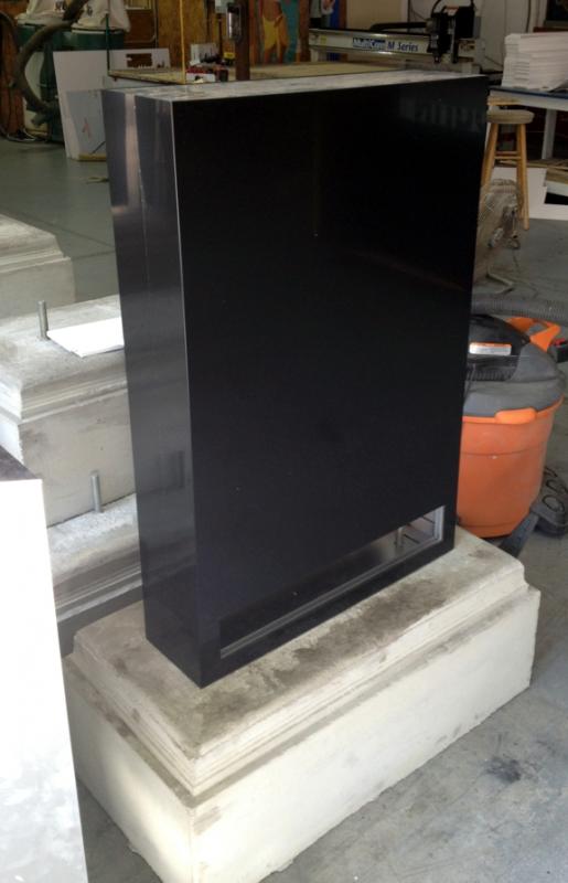

The internal frame is C channel extrusion, and wrapped with polymetal on four sides. All of the various directional signs are v-carved 1/2" PVC shot with single stage automotive urethane. The topper is dimensional with the top of the crest built with .040 aluminum and the university logo on both sides. The white panel on top is 1/8" plate steel that I had powder coated so they can place temporary magnetic signs on when the have special events that need directional arrows placed to direct traffic for the one day event.
All of the concrete casting sit atop another 400 lbs. of concrete footer with 2" galvanized pipe stub that goes 6" up into the pedestal. Had to use an excavator to lift them into position on site.
This one did test my stress levels as a lot of it was all new methods I had never used before. I know the next time something like this comes up will be a lot easier now that I've figured out some of the bugs.

Not a hard coat. It's just a spray on texture coat like Drivit. I used this brand.
[FONT=&quot]Synthetic stucco / Parex 537 Rio Sand Light Base[/FONT]

I have designed them this way, precast makes for consistent finish than pour in place. I have seen them mounted with tubes and with rebar hanging from the bottom and grouted in place.... I'm not a big fan of stucco, I kinda like the raw concrete... Nice set of pics.

Very nice work! That's a lot of work for the bases, but they'll definitely stand the test of time.
Are the faces just stud-mounted to the cabinet?
SignManiac
I spent over a $1,000 on 3M VHB tape alone. I couldn't pull them off at all no matter how hard I tried. It made for a really clean install with no visible hardware on the signs at all. I sure hope the architects made sure the street names were right :) Took five revisions before we started work.
