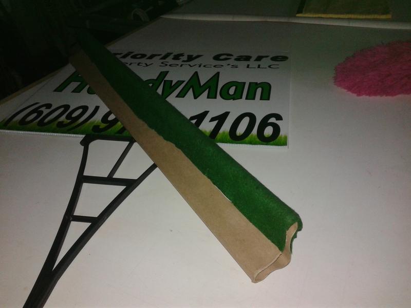

Felt squeegee
Making a squeegee by felt use spray glue. Used cardboard package corners.

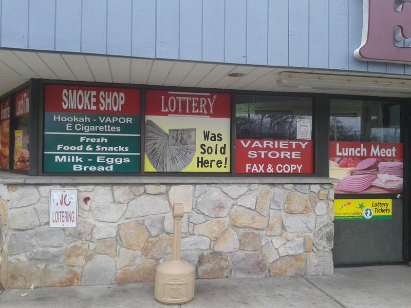

I laminated these prints and installed them with this and the tool is 36" long.
Saved my butT on a solo install
Also put on a flat board it also work with felt.

thats crazy, i would not have thought of that at all. great work and thanks for this.
