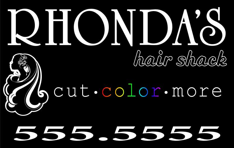

this is something that my boss wants me to do for his hair stylist but im not sure if it looks good enough. Any thoughts on this would be helpful.

Your first instinct was correct.... Too many fonts, squishing the phone number, not enough breathing room around the "icon". Too much happening, and no balance.
i'd start from scratch.

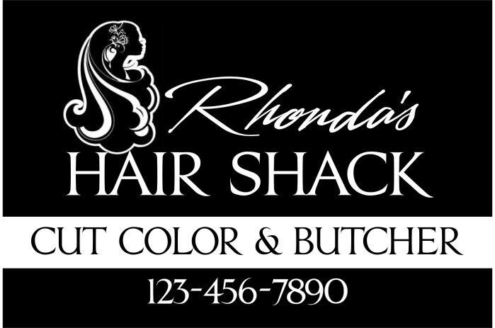

You need more space around things. I shuffled the elements you had and un-stretched your phone number.

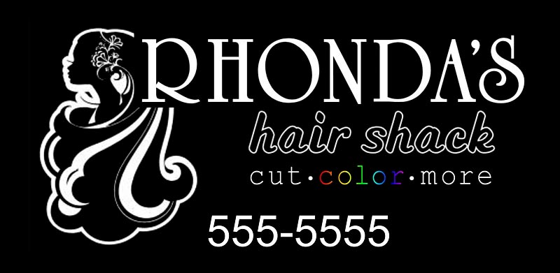

Start over, maybe in this direction. Get rid of the phone number if you can. Depends on where it's going. If it's in the salon then they don't need it.

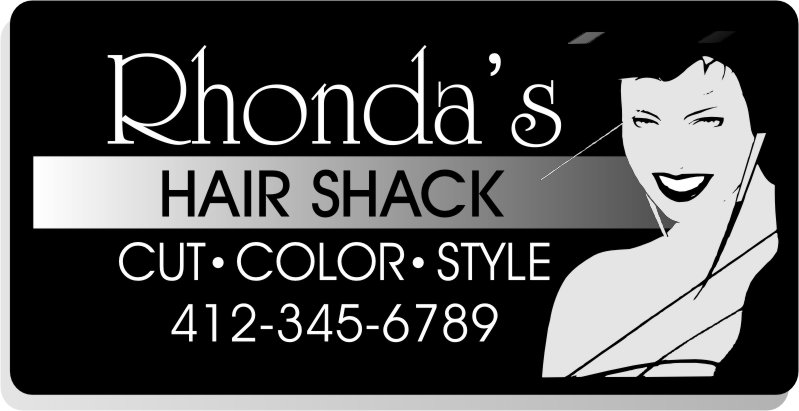

Quickie sticky suggestion.
Yes it's somewhat tacky but with a name like hair shack...
(makes me think of Welcome Back Kotter!)

well im not sure what type of clients she has or is hoping to get. but i do see your point im a rookie to this biz. I have only been doing this for 19 months and just started doing my own design for the last 5 months. I mainly just do installs and help design when he doesnt want to do it or doesnt have the time. But i am soaking up everything that you guys tell me........ so if i havent said it yet thanks for all your help.:U Rock::U Rock:
Rethink your choices of type faces.
University Roman should never be used in all caps. In fact, it shouldn't be used at all except at gunpoint.
'hair shack' goes with nothing, neither in type face selection nor execution.
If you must use that wannabe decco image of the bint with the hair, at least flip it so it's facing in, not out. Make it larger to that it participates in the design, even impinges on the copy, instead of floating there like the chunk of clip art that it is.
Lose the color spectrum in the word 'color'. strictly amateur night. If you want to have a spot of color, put the spectrum in the highlights of the babe's hair.
Give that phone number mouth to mouth, you crushed the life out of it. Moreover, I despise using periods as phone number delimiters. It always looks like the work of a fourth rate typographer working at full capacity. Use dashes.
Don't line up everything like some exercise in mechanical drawing.
Other than that as well as the inherent unreadability of the thing, it's OK I guess.
