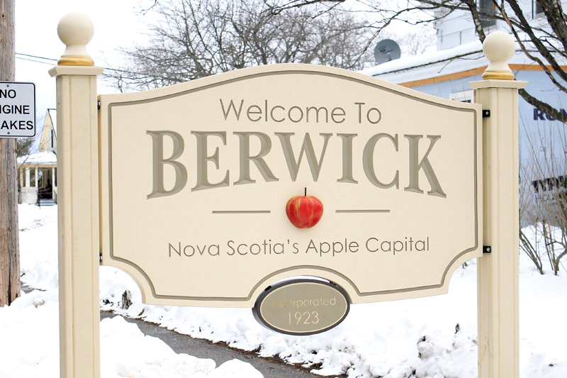

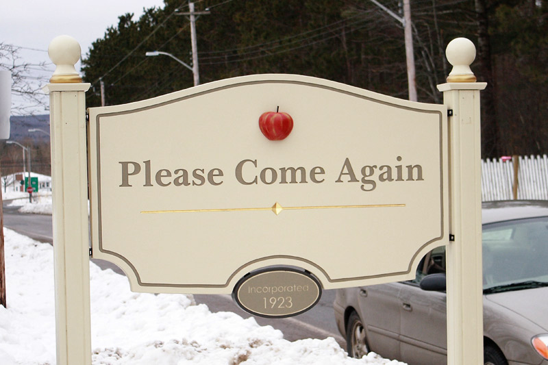

Here is another sign I made for my hometown. I put it up this morning. It's 55" wide and has a 1" square steel frame inside so the local thugs can't smash throught it. The little oval sign in-set in the bottom is held by two embedded steel bars so it looks like its's floating there from the right distance.
When spring arrives I'm putting a stack stone flower bed around the base.
Forgot to mention; the posts are made by glueing and screwing 4 pieces of 1x4 pressure treated decking lumber together like a box. Makes a nice light, straight post.

Those are very classic looking signs...if I were you, I'd be very proud to know they were mine!

Excellent job, beautiful, classic look. Great idea for posts, may use that one day! How did you set the posts in that frozen ground?

Thanks. A post 6x6 was just too big for the size of the sign and I wanted pressure treated so I came up with this idea. The deck lumber has a rounded edge so I routed a groove with a V bit so it looked like a design element. Otherwise it would look like 4 round edge bourds screwed together.
I used quickcrete and hot water. It set up in about 20 minutes. It was only minus 2 or 3 the day I did it and the deep snow had kept the ground from freezing very deep.....yet.

Thanks, it's actually a toupey, gray/brown on almond. It was a crappy day for photography.....bad lighting.
The almond was matched to Alupanel for other projects in the town.

Thanks. I snuck in a little gold on the back side. The next two signs I have to do have a lot of gold leaf on them. I do agree that it can make the lettering hard to read. Wide kerning helps.
BTW, all the text on this sign is sandblasted except for the word "Berwick" which is hand carved.
