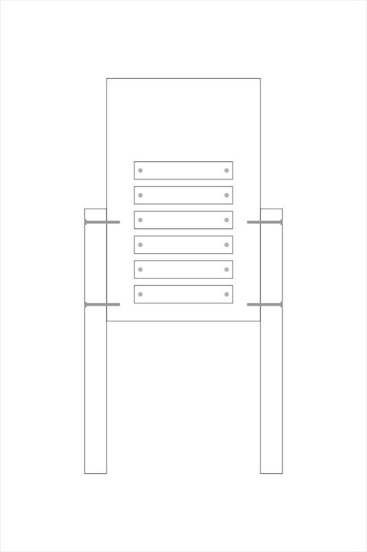

So, there will be two 6x6 feet redwood cedar posts, 3,5x6 sandblasted wooden panel made of glued boards 2,5″ thick, replaceable wooden panels with hand painted names that will be held by studs with wooden caps over the nuts.
The panel will be attached to the posts at 4 points, 2 on each side.
I have glued redwood blanks before, the largest i made was 3x3 feet, 2,5″ thick. I used marine grade epoxy. Worked out good.
They do not want it to be painted.
What finish should I use? Matte polyurethane?
What am I missing?
Thank you!

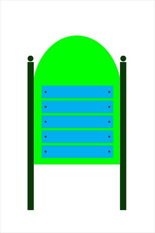

I'd go a little higher with the posts. Mine is scaled and the posts are 6" x 6". Yours look to be closer to 8" x's or something maybe bigger. This should go in the ground about 4' and to do it in certain municipalities, you'll hafta get permits and find out if they need cement or not. 10/4". Never used it. I know they make beams and things that thick, but you hafta be careful if it's end grain or not. Otherwise, your blasting will look like sh!t.
I also never heard of redwood cedar anything. You're combining two terms. It's one or the other. I use two part resorcinol boat glue for all my joints and keep them clamped for at least 72 hours, especially in colder weather. Never had a failure. The wood will break somewhere other than a seam with that stuff. Largest I made was almost 8' tall by 22' long. Horizontal grain.

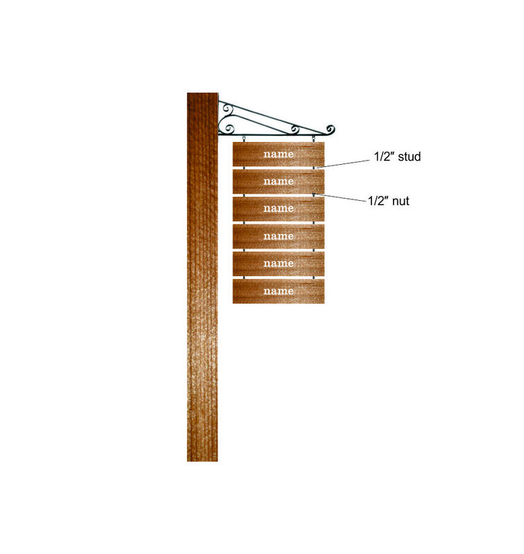

They think it's too expensive and they want to know how much it would cost to make a single post with six wooden plates hanging from a bracket.
I am thinking if using two 30″ 1/2 studs that go through the 6/4″ wooden plates is a good idea.
What do you think?

What is their budget?
And no, I don't think the sign you are suggesting is a good idea. Just scratch that from the drawing board. Bad, bad idea to have all those hanging panels.
You could produce the original sign with MDO, polymetal, and vinyl graphics for significantly less money. But you should find out their budget first and then move on from there at this point. You've already done probably $500 worth of design work. This is where I stop giving options, and say "for X budget, we can do what we can do."

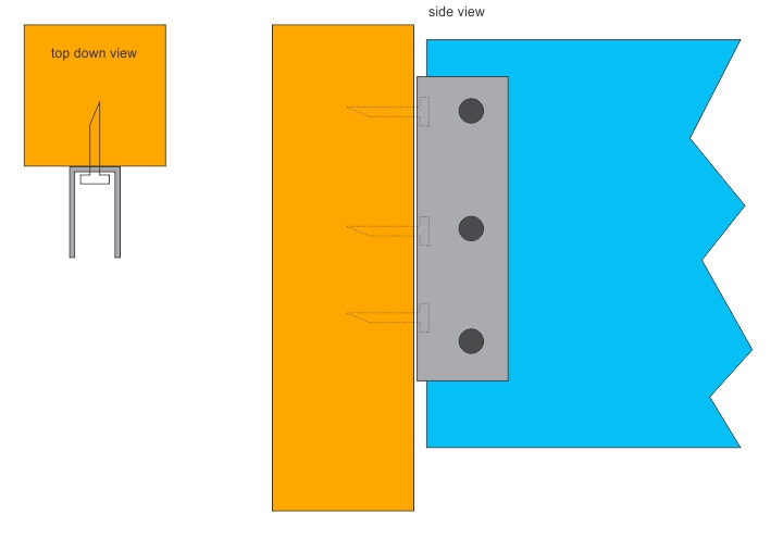

i would offer this for $2500, installed. The main panel is 4ftx6ft 1" mdo, painted a solid color with some vinyl graphics on the top portion. the inserts are polymetal with vinyl graphics, and I'd drill the holes through the material so you only need one set of nuts/bolts per tenant, not per side.
the posts are pressure treated 4x4s that you can stain or paint.
we've been using a big aluminum U channel to install the face to the posts, its been working out great for us. call a local metal warehouse and see if they have something that would work... the bigger the flanges, the better.

How do you attach the board to the posts?
Where does the U channel go, on the bottom or on the sides?
Thank you again.
fresh
there are a million ways of doing this. we've found this technique to be the best combo of economical, fast, looks good, and is durable.
