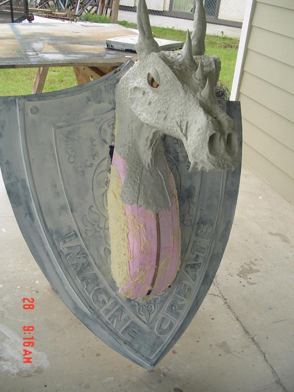

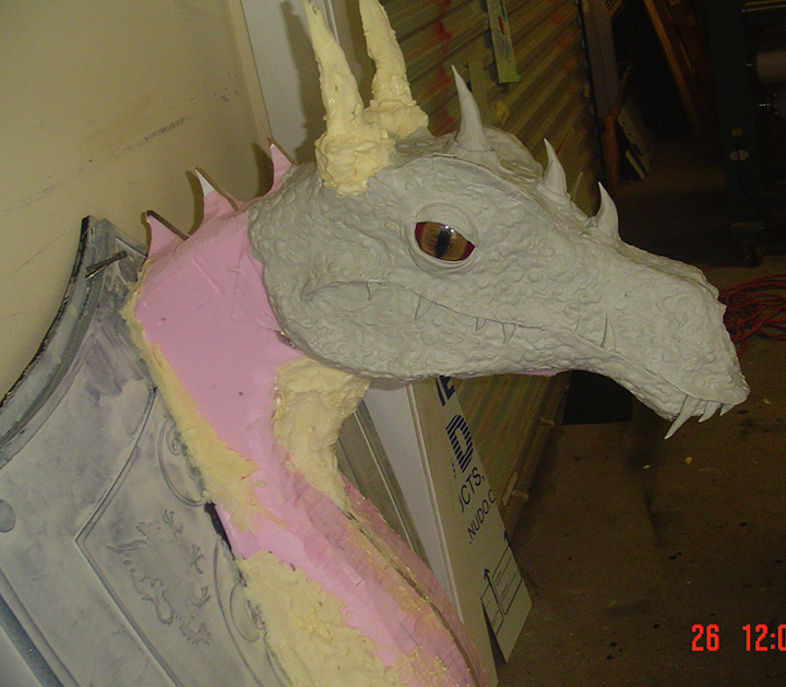

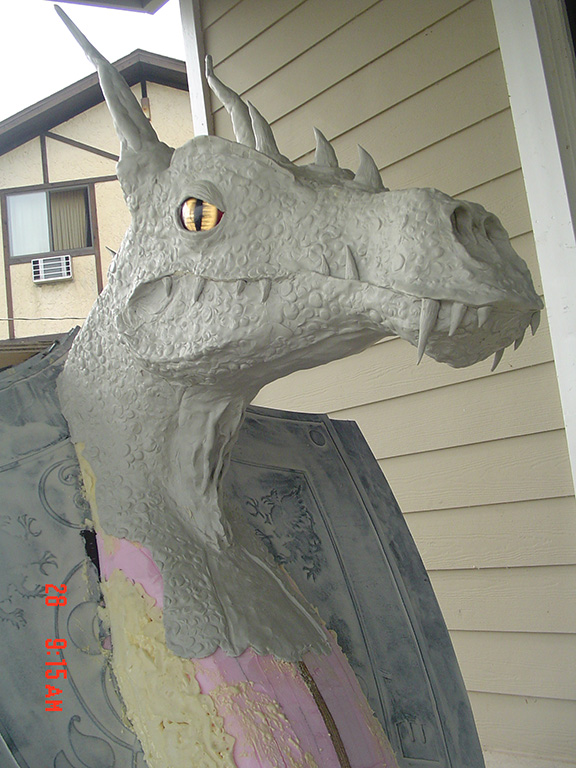

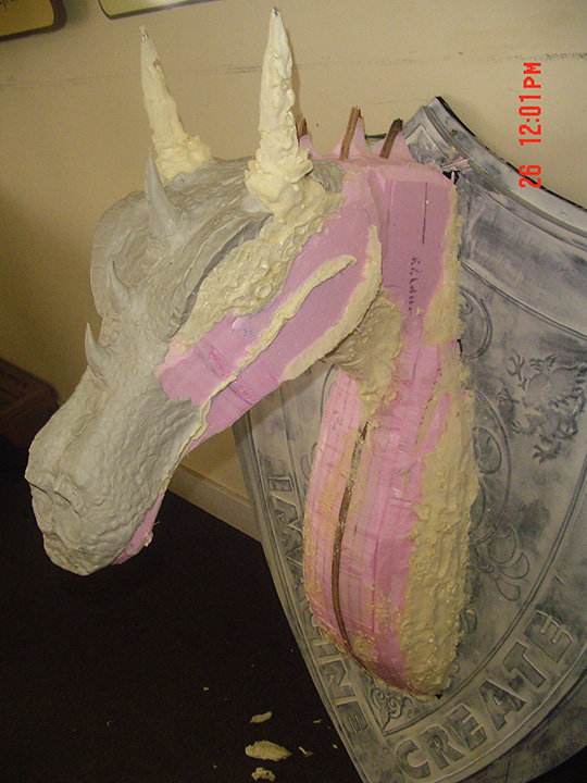

i decided to try the magic sculpt epoxy clay and do me a dragon.... its insides are foam (spary and insulation boards) , wire and mdo. the sheild is insulation board etched with a heat gun and vinyl stencils.
the magic sculpt is amazingly hard once it cures.. i can't break it even small parts like horns and teeth with my hands ( maybe with a hammer!)

What type of glue are you using on the foam panels? I see the MDO in the center, is that for support and mounting?
On your shield you said a heat gun and vinyl stencil. So the foam contracts where ever it is not protected by the stencil?
i used a glue from the hot wire foam factory for gluing foam... the mdo was so i would have something solid to mount to the backer and for support of the sculpture.
the vinyl sheilds the foam from the heat gun and it contracts and recesses were there is no vinyl . it does eat away under the stencil a little and chrome vinyl works best , not as prone to shrinking from the heat.
