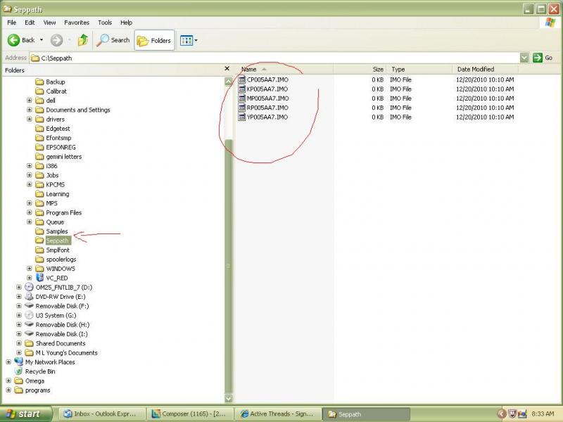

Setpath? I'm lost.. :(
find your seppath folder and delete the files there

Tony Teveris
It's OK to clean it out but in no way has it to do with the pausing, believe me.
We have thought many times about getting rid of these files and not creating them at all. All they really do is provide for faster rendering of a repeated job that contains image(s).
When rendering occurs and the job contains image(s) the IMOs are the result of the original image color corrected, rotated and channel separated. They really are Windows bitmaps.
When a job is rendered and nothing has changed the image rendering just reuses these files, if something changed or they are not there they get created again.
This was done in the early days when computers were slow, today I'm not sure we need these any more.
