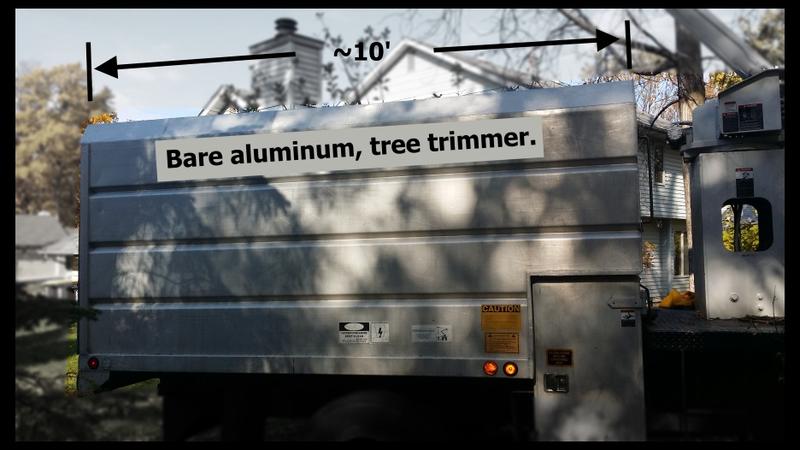

I have a potential client who runs a tree trimming service. He has a bare aluminum panel truck, and wants very simple lettering on it.
I'm old school, so anything I produce will be enamel and brush. How long will 1Shot last on bare aluminum? (I'm in Indiana, no salt air.)
I'm assuming it would be best to have him get the panels coated by an auto body shop. He may not want the cost of that prep work.
If I end up lettering straight onto bare aluminum, how should I prepare the aluminum? Just a simple scrubbing with soapy water and finish with alchohol? Vinegar?
I know this job is going to be fraught with all sorts of problems. :) I just can't turn down easy money, giving a client what he wants.
Thanks in advance for your input. PS: He doesnt want vinyl, and he would rather not have a plywood panel bolted to the side. See attached pix of said truck.

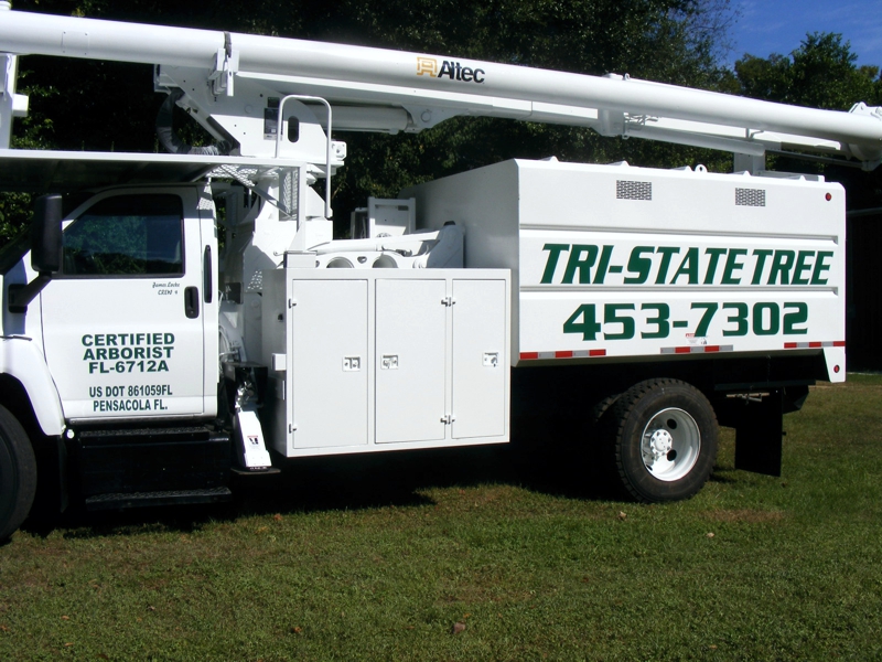

BARE ALUMINUM..........will not hold paint for long. year tops......then it will peel off. i just did 3 of these........BUT THEY WERE PAINTED. i would not paint direct to it. those horizontal panes are 14-15" by 120" long. if he dont want to paint the box, which would be the best thing to do by a professional body shop. THEN YOU PAINT the lettering on it.
option 1. go to a place that sell gutters.......they have white alum on a roll 14"wide..........its like .024-.028. few pop rivits to the side of the box. letter on it,
