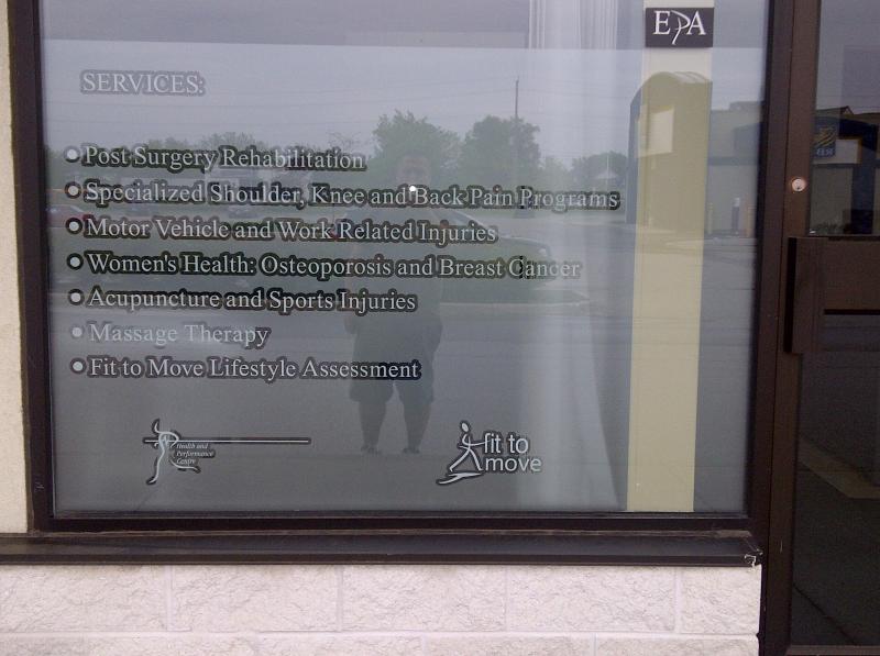

signwizz
is there any text in it at all,also it takes a bit to dry so be careful when u cut with knief it doesn't wander and watch u dont scratch it with your squeegee
