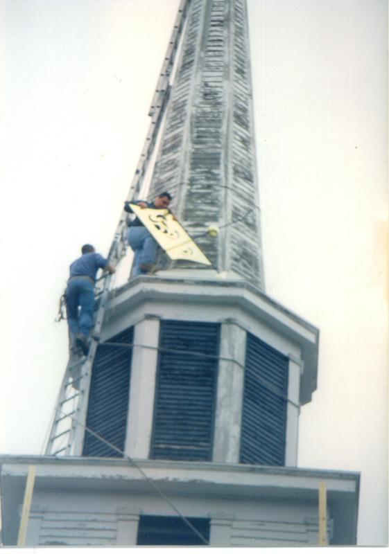

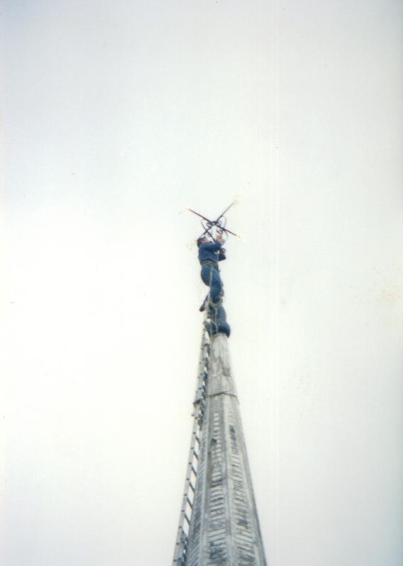

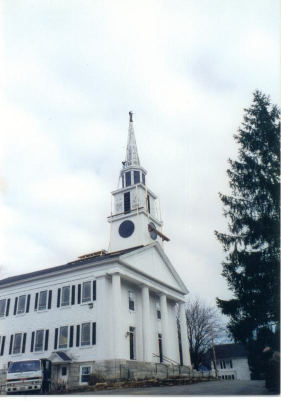

Here are several pict's of steeple jack installing a weather vane I restored for a local church.
Note the extesion ladder with another ladder tied too it so as to reach the top, installer had a safety rope tied around his waist and to the ladder about fifteen feet below himself.

HOLY SH!T... that's insane!
oh the irony... putting up a whether vain and praying for NO WIND!
even God had to be thinking... wouldn't it be funny if...
