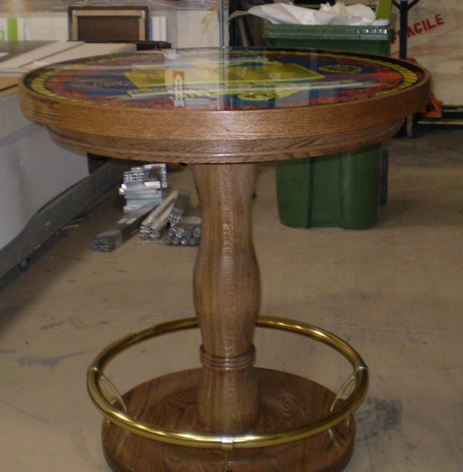

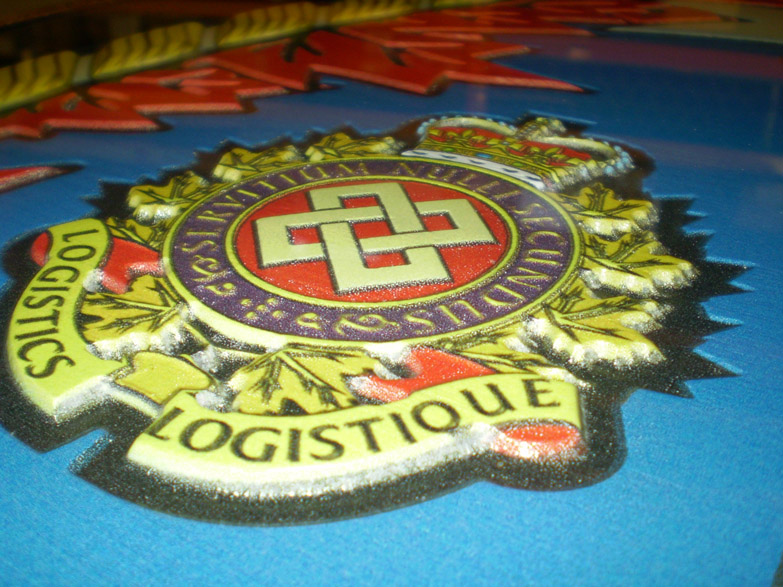

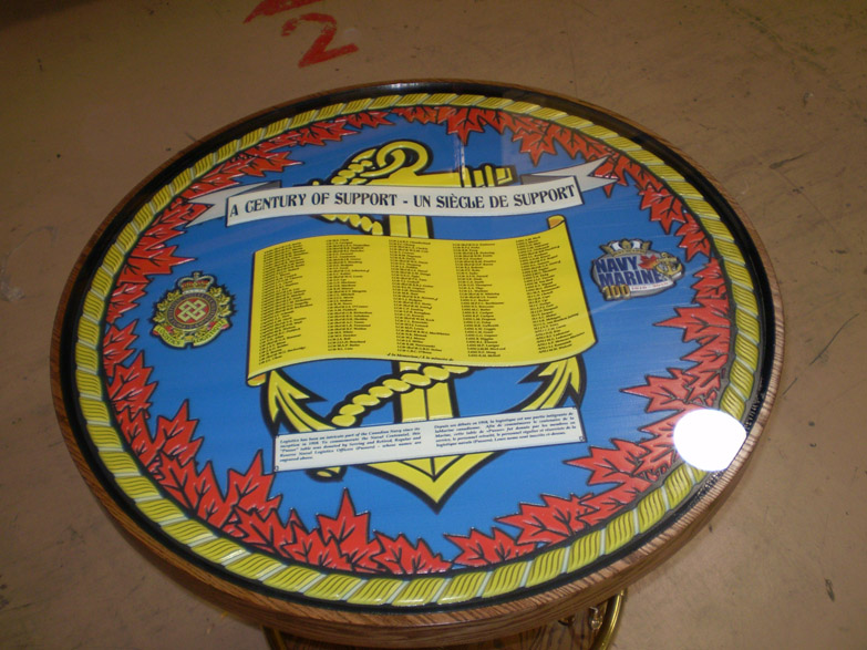

Started this project in May. I'm glad to finally see it crated and ready to leave. I'm happy with the results. This table was commitionned by the Logistic branch of the Canadian Navy to commemorate it's 100th anniversary. They provided us with the table, I designed the top, routed and printed it and we fabricated a frame around it to match the rest of the table and sealed it under glass.

I didn't realize you printed the inks on there. To make something like that last a long time, what did you do to the surface under the glass to get a long life from your inks ??
Is it air tight ?? Will any mildew or something similar eventually appear if it is air tight ??
SebastienL
Gino,
It's routed from 1/2" Sintra (PVC), primed with a waterbased primer then printed. We have a test piece mounted on a outside wall of our building. Been there for 4 years now in the sun, rain and snow, Figure a 60 deg Celsius temperature differential between July and January and it still look's good. The glass is sealed all around in case a drunk seaman spills is beer on top of it, but it is not airtight. So I think it should behave like a framed art piece or poster. It will go in their mess hall here in Ottawa and not on a boat!
