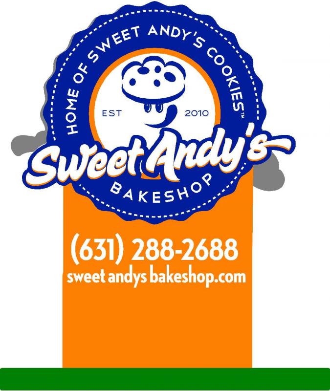

I'm designing, producing and installing my first what I would call real sign (I've done plenty of banners, coro and lettering but nothing like this. If I could get a little insight on pricing on a job like this i would apreciate it. Atached is the plan submited to the town.

What materials and methods are at your disposal for making this sign ??
In addition, I believe your layout lacks quite a bit. Between too many serifs, squashing, repeating, unneeded asterisks, negative spacing and colors..... you need some coaching or help.

Avery? LOL. Use Oracal 751 or 951.
Check out auesign frames they are MM on here, they can hook up up with a PVC frame/post system that are hands down the best I have ever used....then you can use max metal (poly metal) and not that lusterboard that will only last 2-3 years...
Here is their site....http://www.auesignframes.com/default.aspx

Next time post a jpg so more people can see.
Are you sure you want to use that layout?

• Lustreborad can delaminate, I would re-think that and use Alumalite
• Avery can come unglued...try Oracal 951

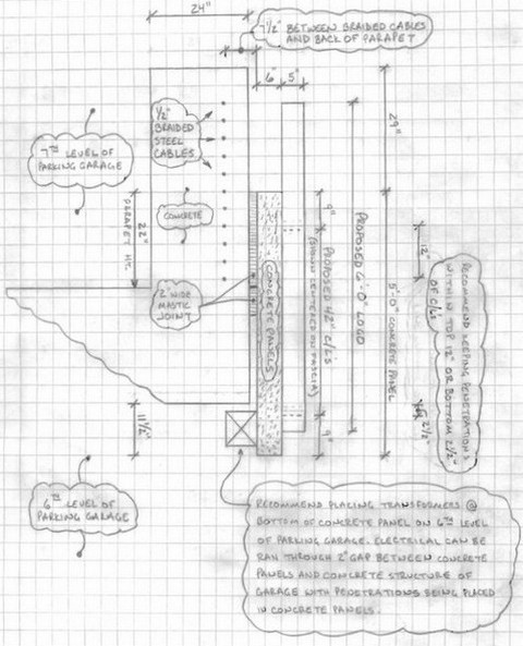

Just trying to help... If you keep your dimensions outside of the drawing of the sign, the art will look a bit more cleaner/professional.
The attached is a survey but shows what I'm talking about.

Hicalibersigns
The ends on your dimension arrows are so long it took me awhile to figure out that they are arrows. Again, this is constructive criticism aimed at helping you to look a bit more professional. Moze is right, they should be outside the drawing. Grab some professionally done blueprints and study the way that they place dimensions on a drawing.

If your going to use lusterboard you will need to have some sort of support on top and bottom to prevent it bowing in the wind. Additionally you need to protect the edges of lusterboard or it will delam pretty quick as compared to other products.
I would recommend a 3/4" aluminum C-channel top and bottom for the board to set in. With drain holes drilled in the bottom channel. Additionally, I also recommend using alumalite instead of lusterboard. The aluminum surface will last much longer than the PVC and will not fade as quickly.
That being said I designed a sign just like this last week and it was build and installed by our shop on last Friday. I don't forsee it lasting long in Ohio winters.

Nothing wrong with a can of worms. You're missing a golden opportunity to do something nice. A rectangle on two posts is boring, it's lifelesss, it's something to be ignored.
For the love get rid of the dang address. If people are looking for it they'll know they're in the right spot when the see the name.
Here's a quick thought...no big deal to knock out with a jigsaw.
Very nice, great advice.
Rick
I was going to draw something up but no need, this is what I'm talking about!!!
Nice!
