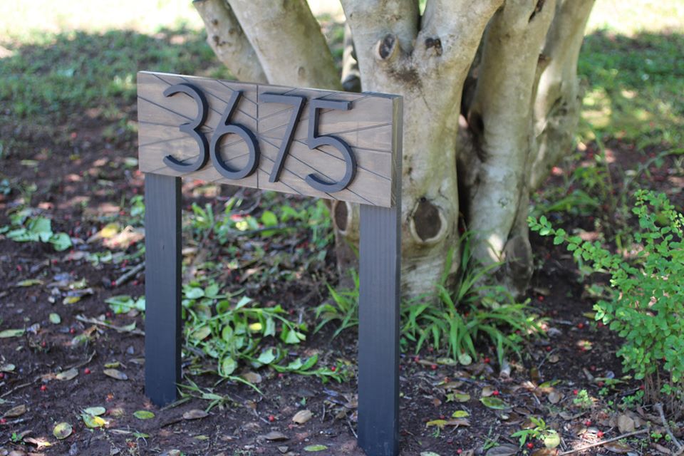

Hi, I make exterior wood signs. I have never worked with PVC and have some exterior grade 1/4”. I was thinking of gluing small pieces (3” wide x 5.7” high) directly to exterior wood/ flat lay. Would this last? I was looking at some different types of exterior glues and figured to check here first for best methods & recommendations. My signs ship all over. Some could be in direct sun and harsh seasonal weather. I was wondering about the possibility of the small cut outs popping off/lasting.
Jessmuhname
543879932952393
This is probably a "stupid" question, considering probably most of you are experts in this area...So, here's a little peek into the typical kind of signs that I make- 100% wood. I know some - things, just little about this field.
:) I could use some newb' help, please

yes you can. Ive had great luck with priming the rear of PVC and placing dots of silicone on rear of PVC and laying them on the wood. Try your best to scuff the wood where the pvc will lay. IMO laying dots of silicone is better than running stripes, if you will. BTW nice clean sign
Jessmuhname
The dot-method is exactly what I thinking! What do you use to prime? Sorry, for the basic question, and thanks for the compliment.

It would help to know what part of that sign is going to be PVC and what part is going to be wood.
For example, if I was looking to make that sign out of non-organic materials, I'd buy wood grain PVC (1/2 or 3/4") for the backer board and then cut the letters out of 1/4" or 3/8" matte black acrylic.
I would absolutely not recommend cutting the letters out of PVC. Black PVC is not outdoor rated so you'll need to do white and then paint it. Cutting it out of P95 black acrylic will be way more cost effective.
