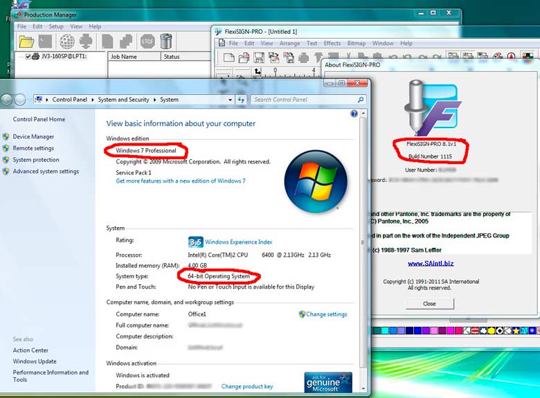

The screenshot below is a clean install of 8.1v1 working just fine on Windows 7 x64 that I just made. I did not do anything special, just installed it normally like any other program. It works just fine...
I will PM you to get you the key id program.
