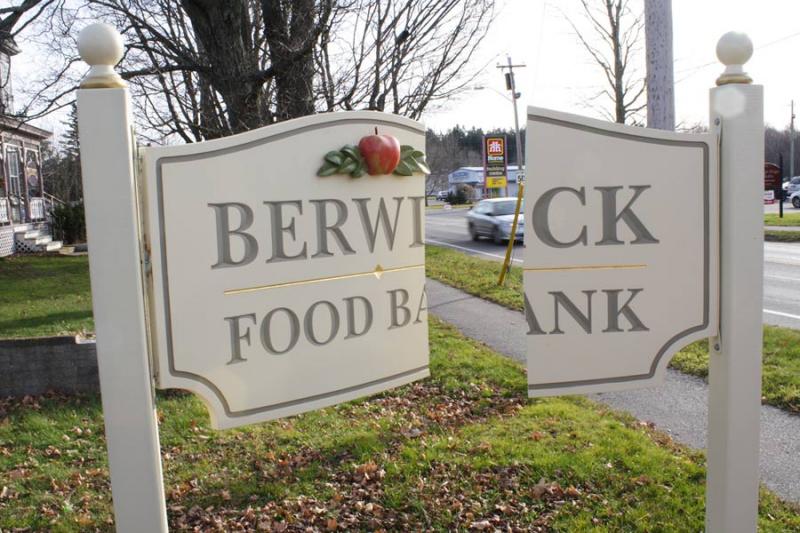

Some little sh*t decided to bust though the sign I made for the local food bank. Really ticks me off.

That is truly a shame after all that beautiful sincere effort you put into that. Do they have insurance? At least that's a good thing about HDU, without too, too much effort you can make a good repair and put it back in service.

looks like you can salvage the applique....
Maybe a print on MDO for the next one instead of HDU?
A moat with alligators around it?

I think it was just too easy to get a run on and shoulder into it. If I put a stack stone flower bed around the base it should prevent that from happening again.

Thought of the MDO idea. Might do it. Just a shame to waste a perfectly good carved sign. HDU sure does snap nice and clean. Should be an easy fix. I can't help but think it's a sport now they've gone through it once.
I built the sign light, without an inner steel frame to cut my cost(it was a donation) but I kinda wish I'd done it now. They might have wrecked it just the same though.

You should be able to fix it, we gorilla glued a 4x8 HDU sign back together from about 6 pieces. It will take a total repaint but you won't have to do all the carving again.

repeat business on a free donation isn't always a good thing...
cut the head off several 1-1/2' finishing nails, sharpen the cut end & embed a dozen double ended spikes in the glue joint... maybe you can catch the little s#!+ with one of the nails next time...
..not that this was ever the purpose of course.. just the standard spliting procedure always done in cases like this :peace!:

That's a real shame but
that's one of the problems with HDU.
When you repair it you could add a flat steel plate along the bottom, or better an angle with it routed into the bottom. And maybe a few steel rods where you join it.
At least maybe they'll get hurt next time.

Maybe back up the HDU panel with 3/4" MDO to provide strength to prevent this from happening. It is such a shame, vandals for some reason are attracted to nice new shiney things.
