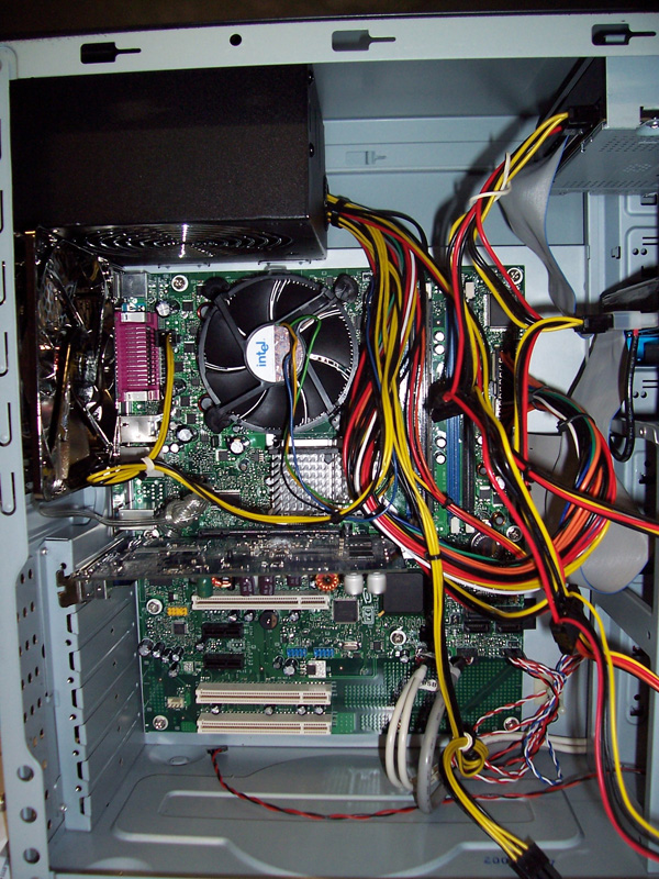

Mobo picture....................

It looks like you have both power leads hooked up to the MB - good
The graphics card looks like it may not be seated properly - try removing it and reseating it.

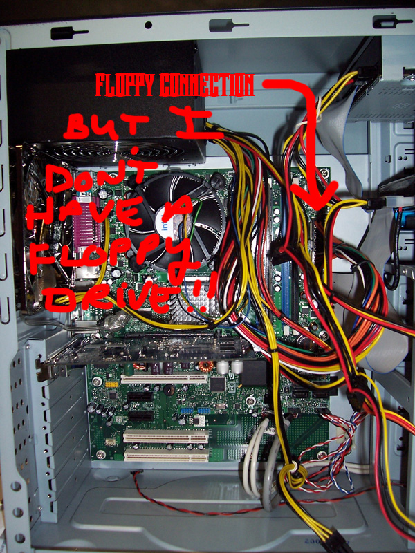

Does that MB not have a floppy connection??
Your case speaker is not hooked up from what I can tell, it should go on the connector just above the other case connection, and have to leads coming from the MB.
Go through and recheck your case connection, make sure you have the power led and power switch in the right places.
That graphics card not aligning with the screw holes it what bothers me the most though.
Shovelhead
The mobo has a built in speaker I deciphered....
I was having trouble locating the connection on the Mobo.
The graphics card is seated properly on the mobo pin connection.
I had to bend back were you're looking in order to seat it properly....
It was a very snug fit.
I went online and some people were having trouble with this barebones
as far as stuff fitting properly but again...it is snapped in there.

Try the next slot down for the video card. I just built a new box and the top slot wouldn't line up easily but the others did.

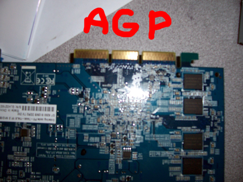

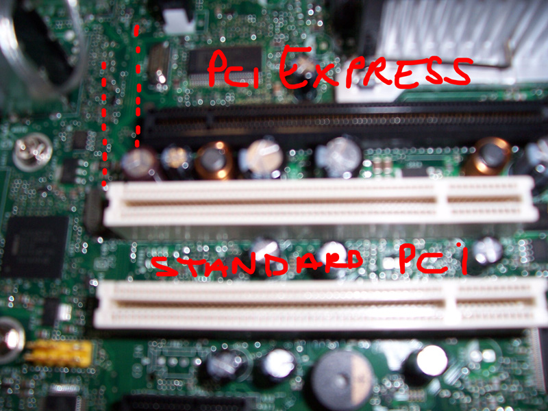

I've just been informed......
that I have and AGP video card....the specs and box say PCI Express....
so that explains the tight fit.....this is getting complicated.

Ouch, that probably explains a lot, like I said I thought something looked wrong with the graphics card.

tigerdirect is pretty good.................
although it's ultimately my fault this particular card was on the PCI Express page............I did a little altering to get the card to fit....they wouldn't take it back....a $94.00 lesson.....oh well.........half price to whomever wants it is my co-worker can't use it.......
XFX GeForce AGPx8 512 Mb DDR RAM II......regularly $94.00
...........................................scratch and dent $50.00

Not.
Both cards use a standard PCI slot on your motherboard. Try moving it down one slot and you will see a difference in the fit.

is it as simple as plugging the DVD into the available floppy slot on it's own ribbon because that's the only way that I can have a separate connection.
I don't recognise any of the other connections on the drives
