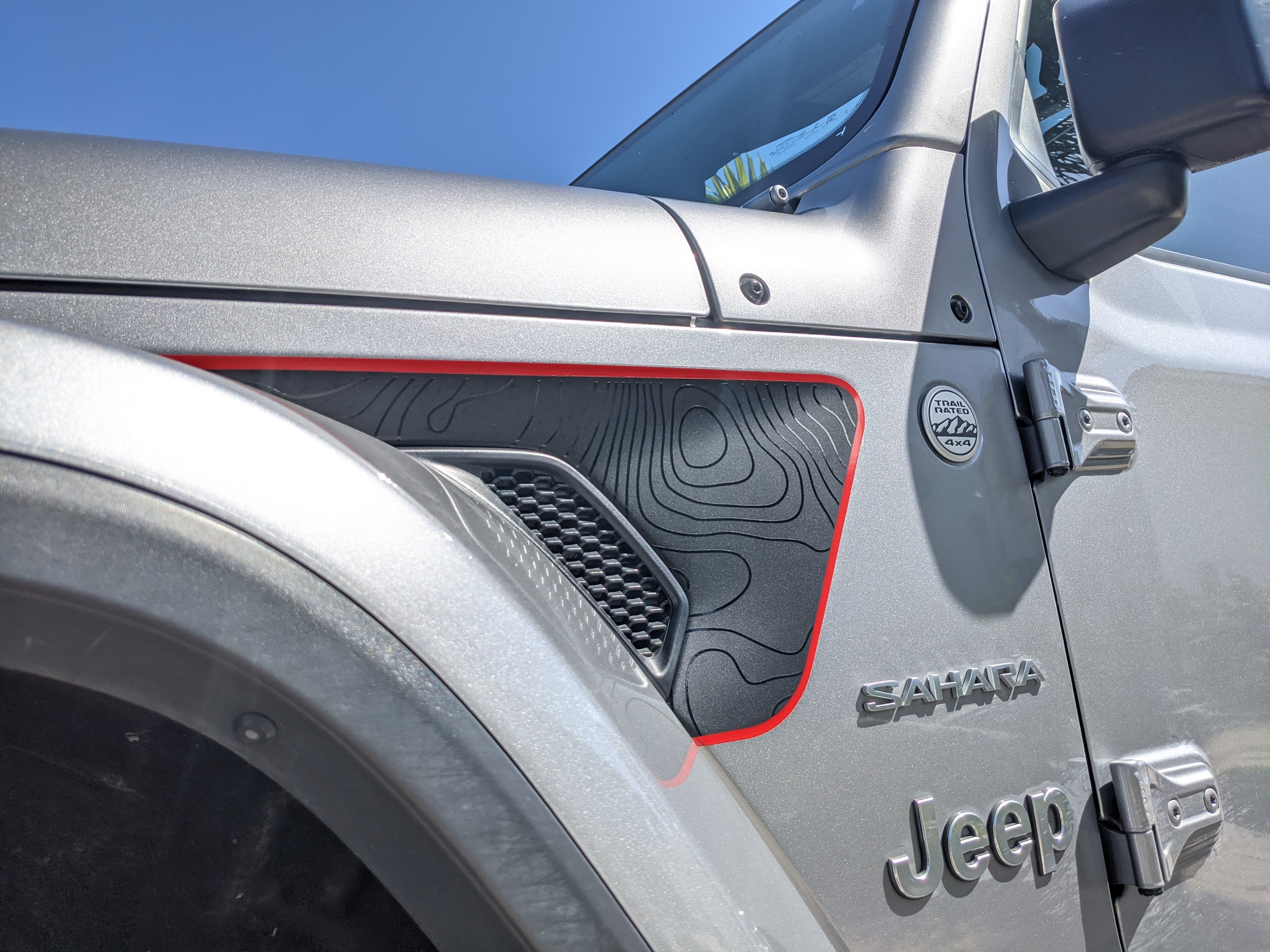

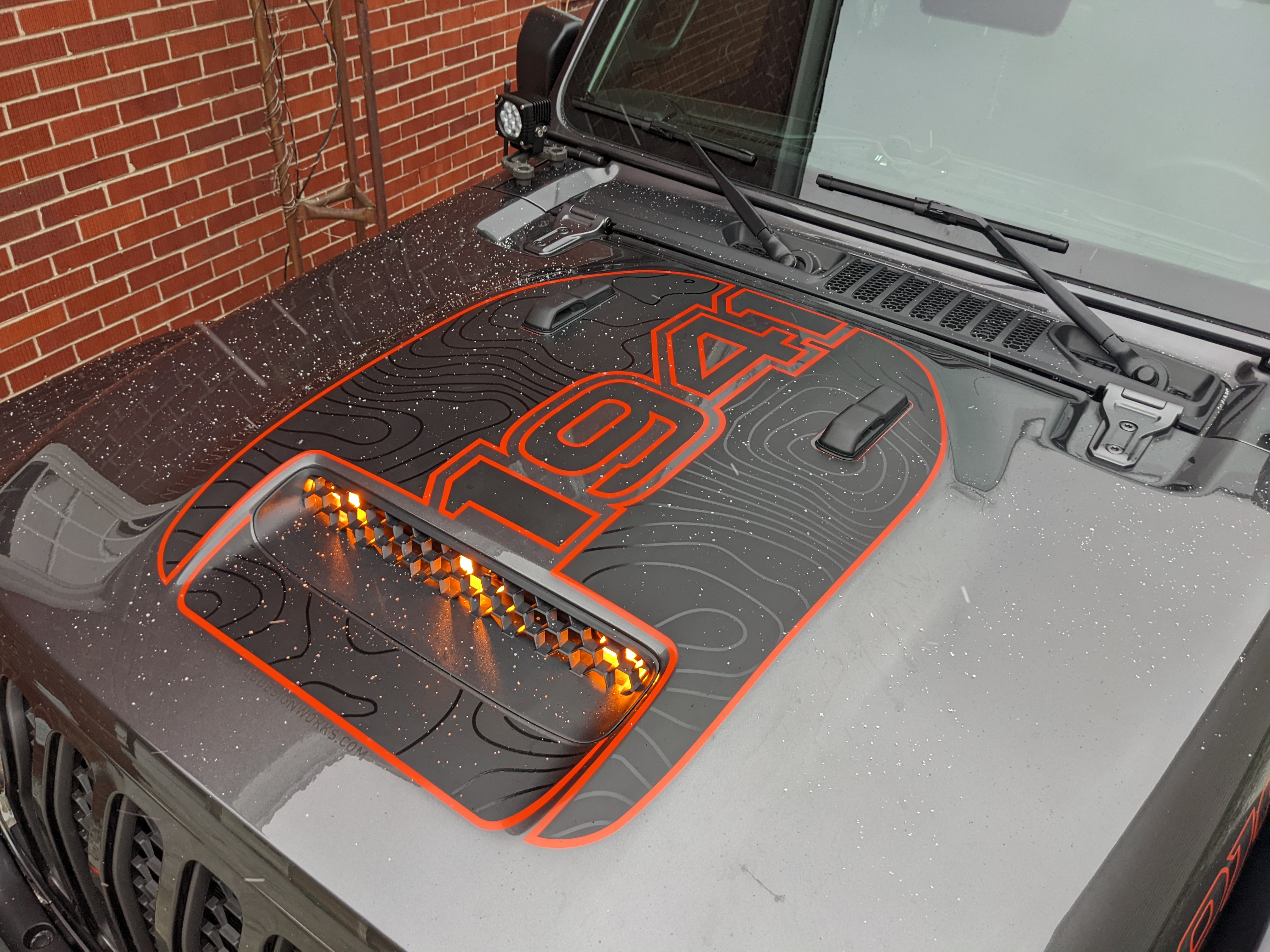

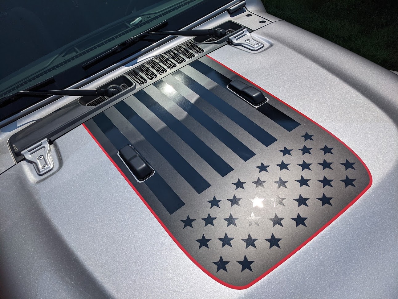

I'm looking to find a better way to make some decals with a gloss design on top of matte black and a color boarder. I've been layering to this point, but want to step up my game.
I've been designing and selling decals over the last 3 years. Started out as a side hustle (while a full time designer at a trade show House), but ended up making it a full time job.
See attached for some examples of my layered work. I'd like to try and do this in one piece if possible. Most of all the decals I have are less than 24" wide, but I'd be interested in a little more width (slight space constraint with basement shop).

I'm looking to print these styles of decals instead of cutting and layering. Hoping to speed up my process with less weeding, and also making the installation easier for customers basically.
I don't necessarily need to go to a larger machine, but it looks like most of the printers are all pretty much larger than the 24" graphtec, so I'm open to up sizing the cutter too if needed.

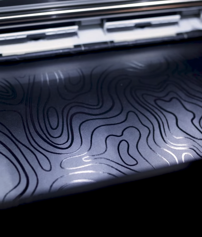

Thank you! I've been doing it this way for 3 years, and just saw someone who basically is doing the same thing and the gloss is definitely printed. (There was a closeup video of the printer working). I'm pretty sure they won't want to share their secrets with me

Sure- you can see it a little bit down on their "black on black" section
And I definitely don't want to come off as if I'm trying to steal anything from them at anything like that. I just want to stay competitive in the market with my existing designs.

That's HP Latex printing on it. I guess you can make it seem very "pop" like that. But it looks different when the ink dries.
Cheapest is like $10k so there you go. Not very big secret...
