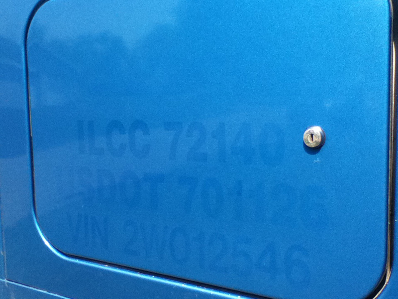

I just happened to be reading over a few posts this morning while getting ready for work and it also just so happens I had a '02 Mack truck coming in for some vinyl removal and new graphics. So I figured it would be a perfect opportunity to collect a picture for you to show your client. This image is from the storage hatch door. This part had the worst ghosting of the entire truck. The reflective white vinyl that was on it must have been on it for 10 years because we had to use an eraser wheel to even touch it. Anyway, I hope this is kind of what you had in mind to show your client.

That's exactly what I needed! Thanks so much.
