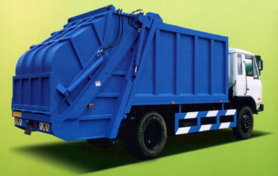

I have to put about a 6 ft wide by 3 ft high sign on a garbage truck, but the truck has about a 4" wide raised vertical rail, then flat for a few feet, then the rail again.
So, applying the media straight to truck/magnet cant work due to raised/unraised surface.
I thought maybe I should use aluminum but I need to ask...how can I attach it to the truck?
Am I on the right path, any opinions?
Thanks in advance!
Image below to get idea.

I have always found those ribs to not be ribs at all. On the ones I have done thats is actually a structural steel skeleton that gives the box strength for the compaction. The walls are smooth inside there... but, trust me, just take my word for it :)
So I always check above and below for any indication of wires inside the rectangle tube and then used a GOOD stainless steel self drilling screw (not Home Depot hardware) to mount aluminum signs.

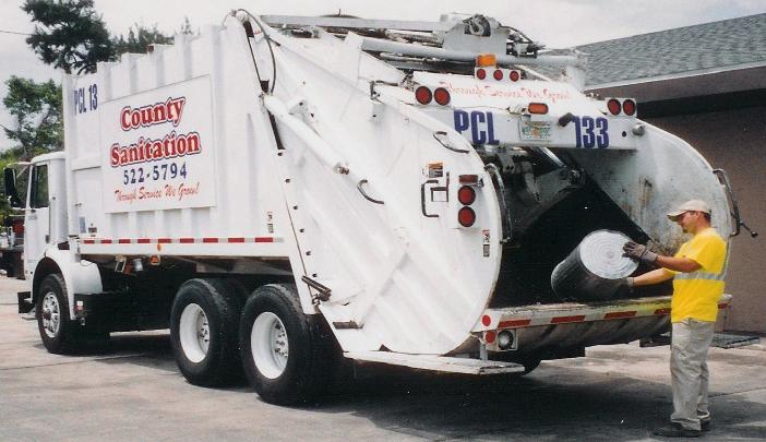

We do just like that pic with 4mm dibond, silicone & big pop rivets or self tappers.
We've painted the panels to match the truck body if necessary.

So do I need to find out what those "tubes" ar emade of, or what's behind them.
I just get this feeling I have a hard time penetrating the surface (please no jokes, lol)
Should I find out make and model and research that?

They are hollow and not that hard, we predrill. The silcone cuts down on any vibration and seals the screw holes.
Most all the trash trucks we've done over the years have been lettered on steel panels and the company welds them fast. Most of these big trash companies have welders right in shop for repairing these monster trucks and can do that work in-house.

Im not too keen on welding a finished sign to a nice new paint job, unless it is re sanded and primed/painted properly in that area welded, it is going to be the first place to rust. we did a couple dozen panels for a trash company a couple years back and installed with stainless teck screws and the holes encapsulated in silicone. Now the whole trucks are smelly rust buckets except the signs.
