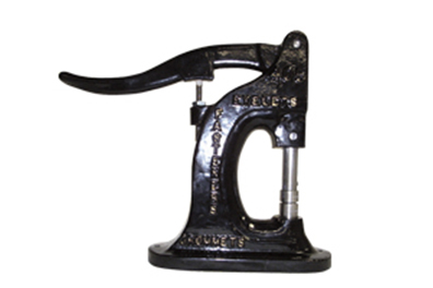

I can tell you though that there is a world of difference in hand grommet press, especially when speaking
about shoulder torque. We always used Fasnaps (left pic), but when we got a a stimpson (right pic), that's the one everyone
wants to use, especially women... even though it's a more basic press, it takes way less force to press a grommet.
I would also suggest you try using whatever press you're using at different heights, it's all about getting the right leverage.
I find the higher the table top the better, that way you're pulling down the handle instead of trying to push it down.

After years of using a no-name press I purchased off eBay (and still going strong btw), the general consensus was that it was hard to use and the lever didn't generate the proper leverage for smaller/weaker/older persons who tried to use it. Now, it wasn't a problem for me, but I'm a big guy - for instance, my mother (65) would sometimes come in and help us hem banners but couldn't use the grommet press to finish them because she wasn't strong enough. Finally purchased a new Hiker end of last year and wow what a difference! Everyone can use this thing, loves to use it and it is always used before the older version.

+1 on the Stimson- we suffered with a Fasnap style for 15 years and everyone would hide when it was time to grommet, now it is a pleasure (well... you know what I mean). And we grommet a lot of acm - it will punch right through. If you use the thicker aluminum acm (read expensive) it 'might' be different.

OMG............... I got our new hiker hand grommet press in today and all I can say is WOW. It will set grommets in acm witn one hand and very little efforts.

Yup, they are really nice and again, anybody should be able to set grommets with it. I bought it only after my Fellers rep told me they did tryouts in the office and EVERYONE could use the Hiker easily, and while the Stimpson is a great machine, a few smaller/older people had issues with getting enough force to set the grommets properly in certain materials. Happy with our decision, I'm sure you will be too.

Hiker here. Works perfect every time. Doesn't take much force to work. Does take Hiker grommets tho.
