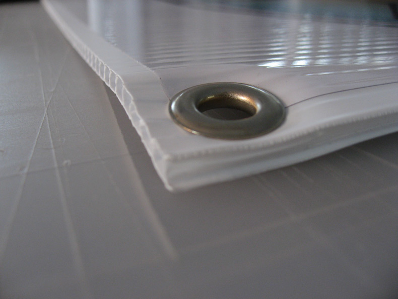

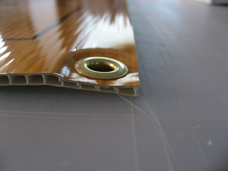

This is what I get with standard grommets and press . . . There's got to be a way to avoid this damage and correct the spacing/crushing !

Replicator
thanks Bill43mx . . . If that is the case I would like if someone with the precise knowledge would chime in with the exact grommet to get.
My grommet machine does have a stop on it . . .

I have a Stimpson Grommet press and some standard #2 (3/8") grommets. Just tried 4mm coro and moved the stop up a bit and they hold quite well. The collar on the grommet is only 3/16" long but seems to have a good hold on the coro with only a tiny bit of compression in the coro. Any thicker coro and you would need a longer shaft on the grommet.

I understand that works pretty well, until you add the laminated print and then the thickness is just out of reach for the grommet.
