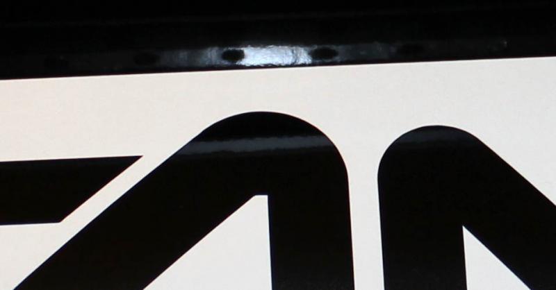

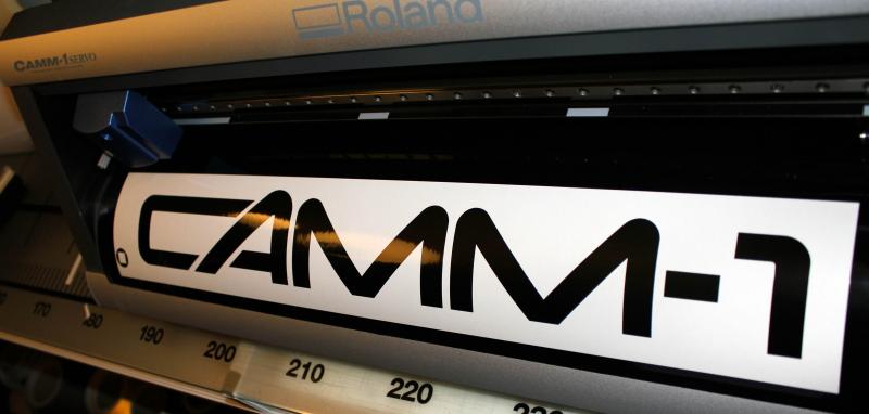

Haakon
Nice and smooth cuts on mine, its about 6 months old. But it runs without a glitch all day everyday though..
Edit; Close-up:

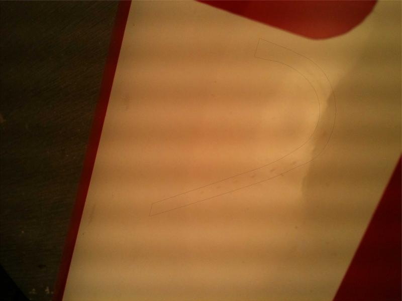

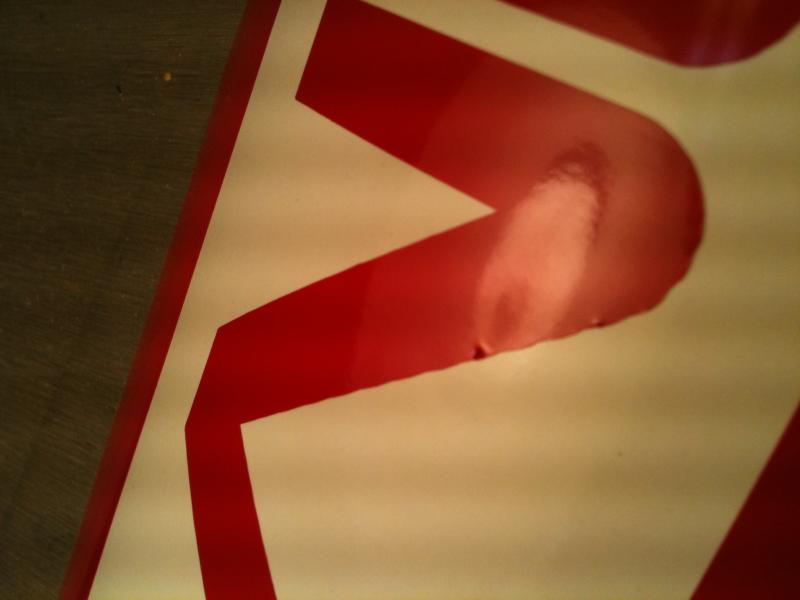

Okay, so I got my machine back from the roland service center & this is how it's cutting the self test. All I did was plug it in the wall, put in a brand new roll of oracal 651 red & performed the self test. The one pic is of the stitch pattern the machine makes when it's cutting diagonals & I put a cheesy outline around it so you can see it. I can hear a feel when it makes those cuts, like it's skipping or dragging.
So I ask, what did I do wrong :help
