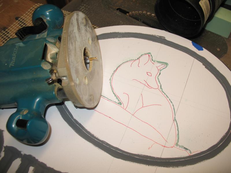

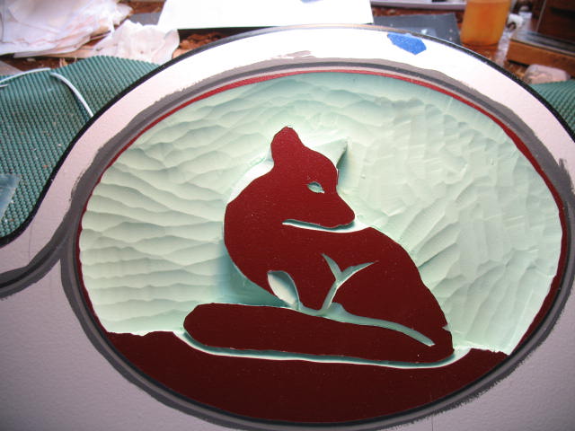

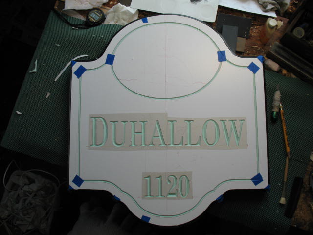

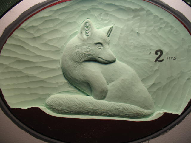

This is a two sider...2"thick x 24" wide x28" tall. Oval with fox is 9" x 13". Coora Foam (Duna) 15lb.

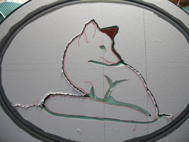

Panel is pre finished and masked and the letters carved. About 1hr and 10 min. a side.

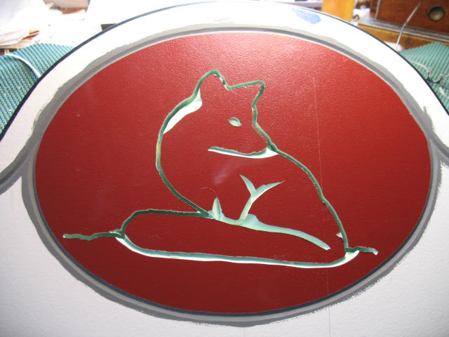

After the pattern is transfered with Saral Paper, I cut the stop cuts with a 1/8", up-cut bit. then using a small knife, I outline the remaining details with a "V" cut.
The mask is then removed.

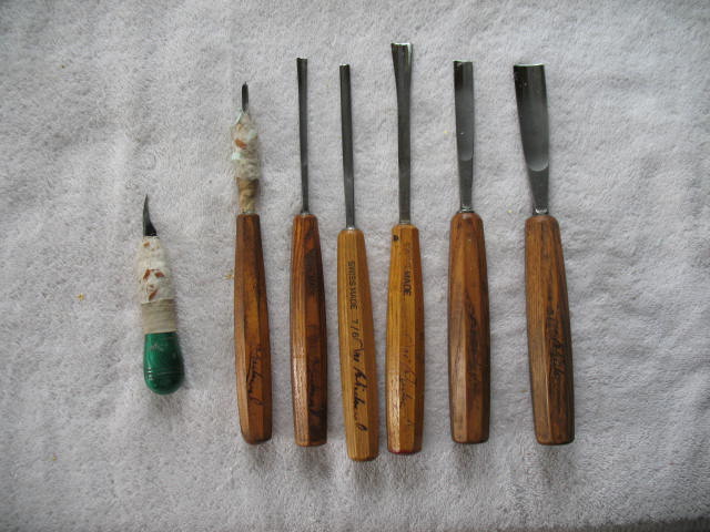

Here are the gouges I used.

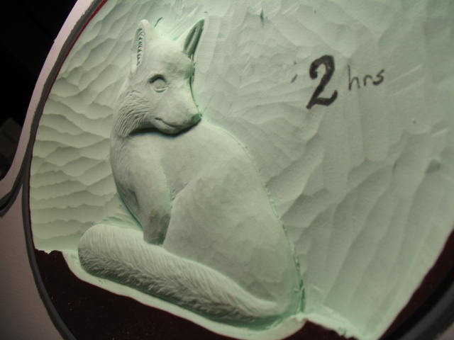

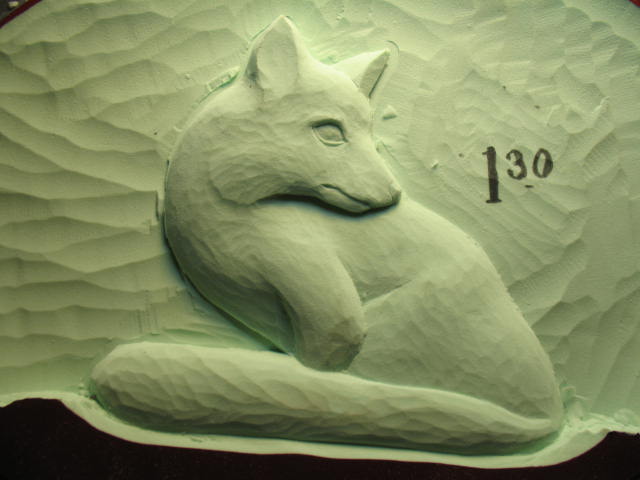

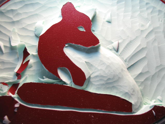

mrchips

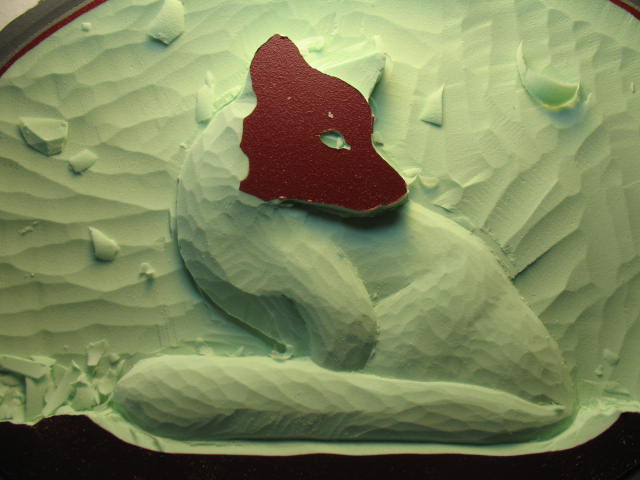

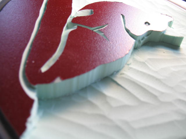

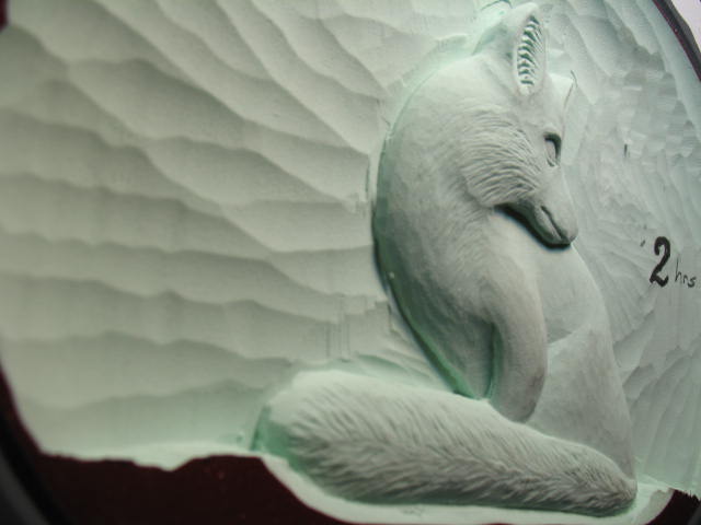

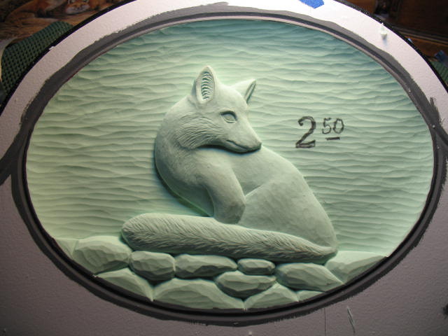

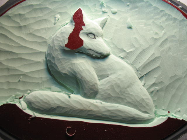

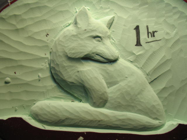

Here are the photos I took at key points in the carving. Time markers are written in the ground.

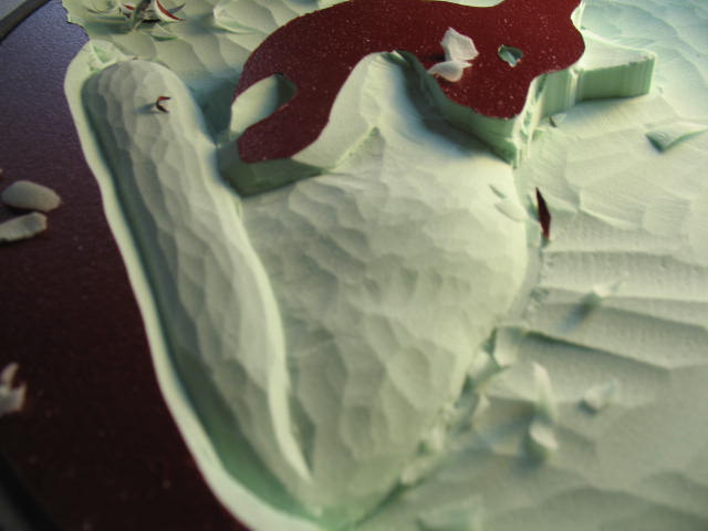

mrchips
Keepin on..............

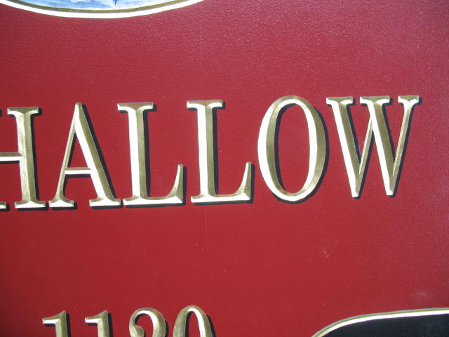

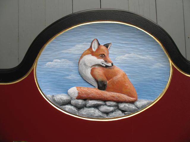

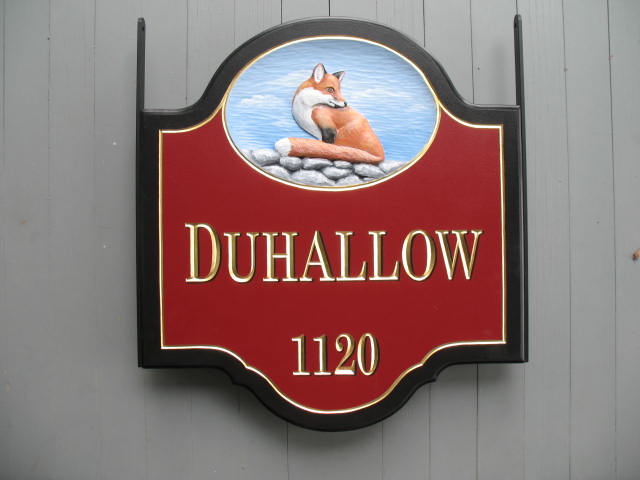

Here she is finished up......
I know holes don't cast shadows but I really like how it makes the letters pop.
Thanks Again!
Joe

SignManiac
Joe, I had meant to ask yesterday about the finishes you use on your work? Are you working with enamels or latex? They really do bring out the subtle details in all your carving. I know you're in the Northeast, how are they holding up against the weather?
mrchips
Thanks everyone!
I use the acrylic laytex on all my HDU projects. I really don't have a good handle yet on painting images with it...............I gotta get some lessons. The staining techniques that I am comfortable with (on wood) are similar to using watercolors.....layers of washes. BIG difference!
The wood signs get 5 coats of polyurethane but need "refreshing" every couple of years. I've only taken one order for wood this year.

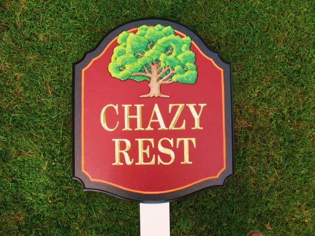

Here's another recent one.....HDU/laytex....The exposure on this is bad but you get the idea.
Joe,
Makin Chip$ and Havin Fun!
