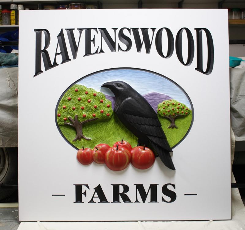

Here's one I just finished. It's 4'x4' double sided HDU. The little apples are magic sculpt. The raven and the larger apples were carved out of HDU and applied. The rest is carved in place.
This is the first sign I've made for a farm so I'm hopeing some other farms will get into some "one-up-manship" and I'll have a few more to do.

awesome work Adrian...
ever posted any video of your carving?
I'd love to see the process of doing the incised lettering!

Wow, smashing or carving wood you seem to have it down pat, nice stuff once again.

Doug, I might give that a try but I don't really know anything about posting videos. I have a camera that will make avi files but they seem pretty big to me. Is there somewhere I can get some info on this? (I know... "let me google that for you") but since you did some videos I thought you might be able to steer me to the place I need to start. It took 20 to 30 minutes to carve one letter so I'd probably have to edit out a lot of repetitious stuff.

As a joke, you could cut a little cartoon balloon out of PVC saying "Nevermore" and attach it to the sign.
It could have a little chip saying the same thing
(like those greeting cards which talk when you open them)
I'm kidding!
I like the starkness of the black and white.
It's clean and a nice balance for the colorful pictorial.
Love.....Jill

Thanks Jill. I designed it for viewing from a distance so I exaggerated the depth of the cuts and the colours quite a bit. The raven's feathering is quite deep because it is painted plain black with no highlighting and I wanted the shadows and reflections to give it some dimension. I won't know how it went until I see it installed.
I also need to figure out how to carve trees. I don't remember ever carving a tree before. These will do but I'd like to have them look more realistic somehow. I'll have to study how other people have done it in the past.
I think I have apples down pretty good though.
