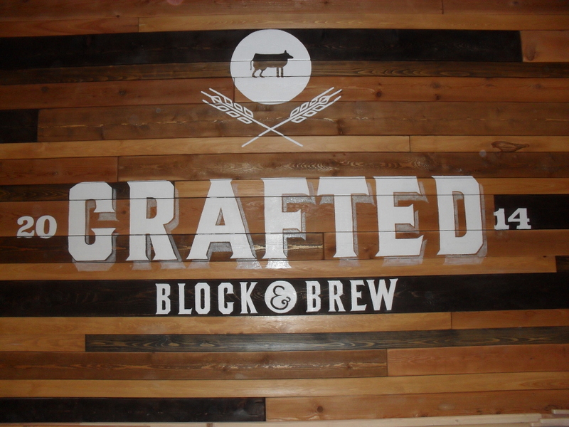

Hand drawn & lettered
Craig Sjoquist
Just finish this in 12 hrs start to finish including sales & check in hand,
Sold by Mylander Murals, designed by Mellow at Knight agency, I confirmed on Thurs, what needed to be done, drew out pattern by hand using grid formula on Fri., started lettering on Sat. finished Mon.
There are kerning issues but designer knew nothing about that, like the big gap between the F & T tried to tighten it but she wanted the shades not to touch a letter, so I opened it back up along with the the R & A so it would not be so noticeable, she was nice & learned a little & I was happier.
It is lettered in Ronan's Aquacoat using 3 Mack 2962 brushes 2 coats the shade Aquathane clear with white added.

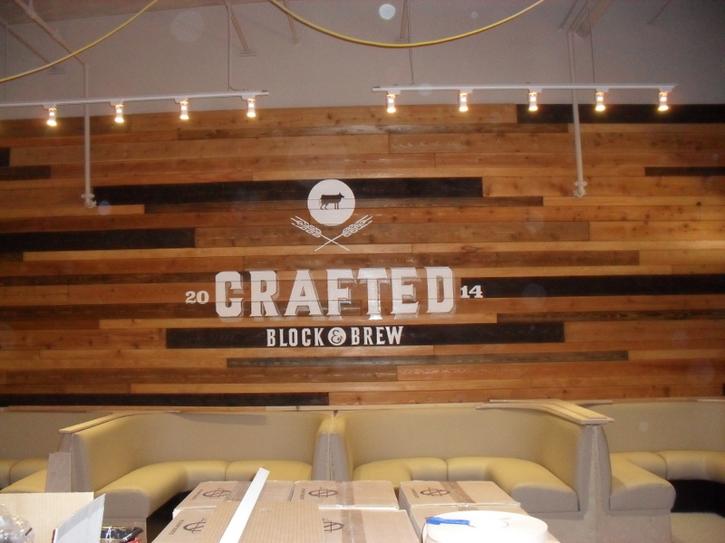

Note it was done with ladders, ladder jacks, 8ft plank over booths as you see in distance picture.
If in Orlando it is in the Metrowest area & looks to be a outstanding restaurant, with well experienced people operating it, the menu will be very tempting indeed.

deegrafix
Very nice! True craftsmanship.

Deegrafix .. I been hand lettering 39 years 29 in Orlando area so this is sorta common, doin signs that a digital lettering does not work well.
Have a large job coming up shortly wooo hooo, also a good deal of my work has been window splash, someone is having a sale in the bright colors on windows.
Most of my work will be on scaffolds, ladder jack work is rare when doing higher stuff, only if it is the only way.
