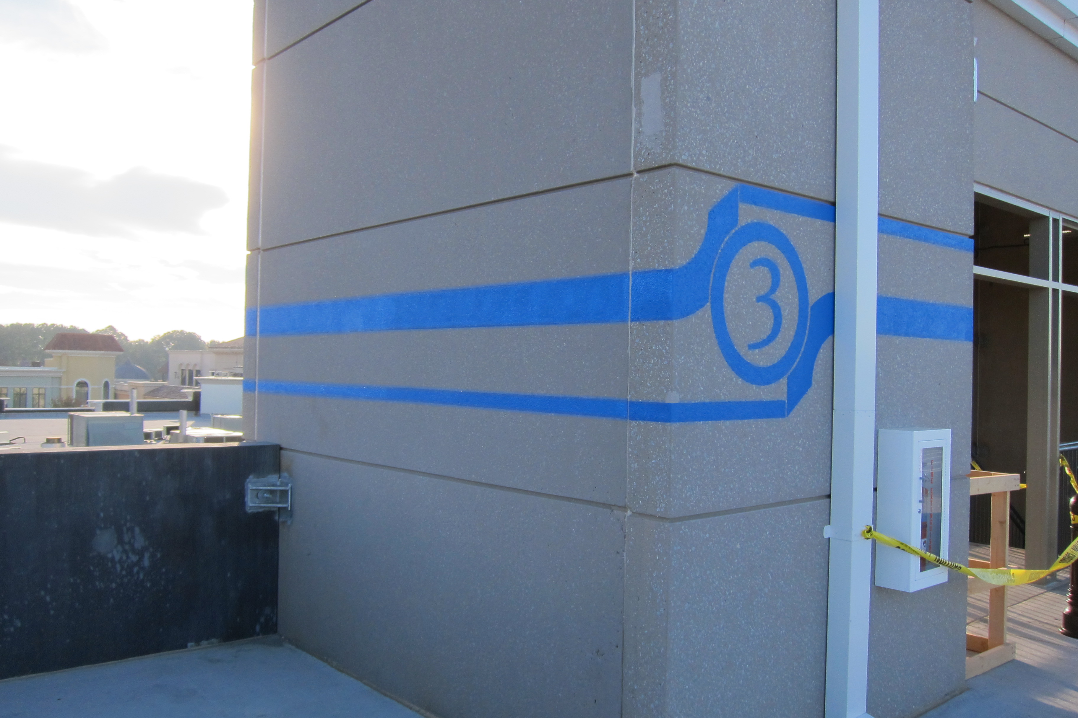

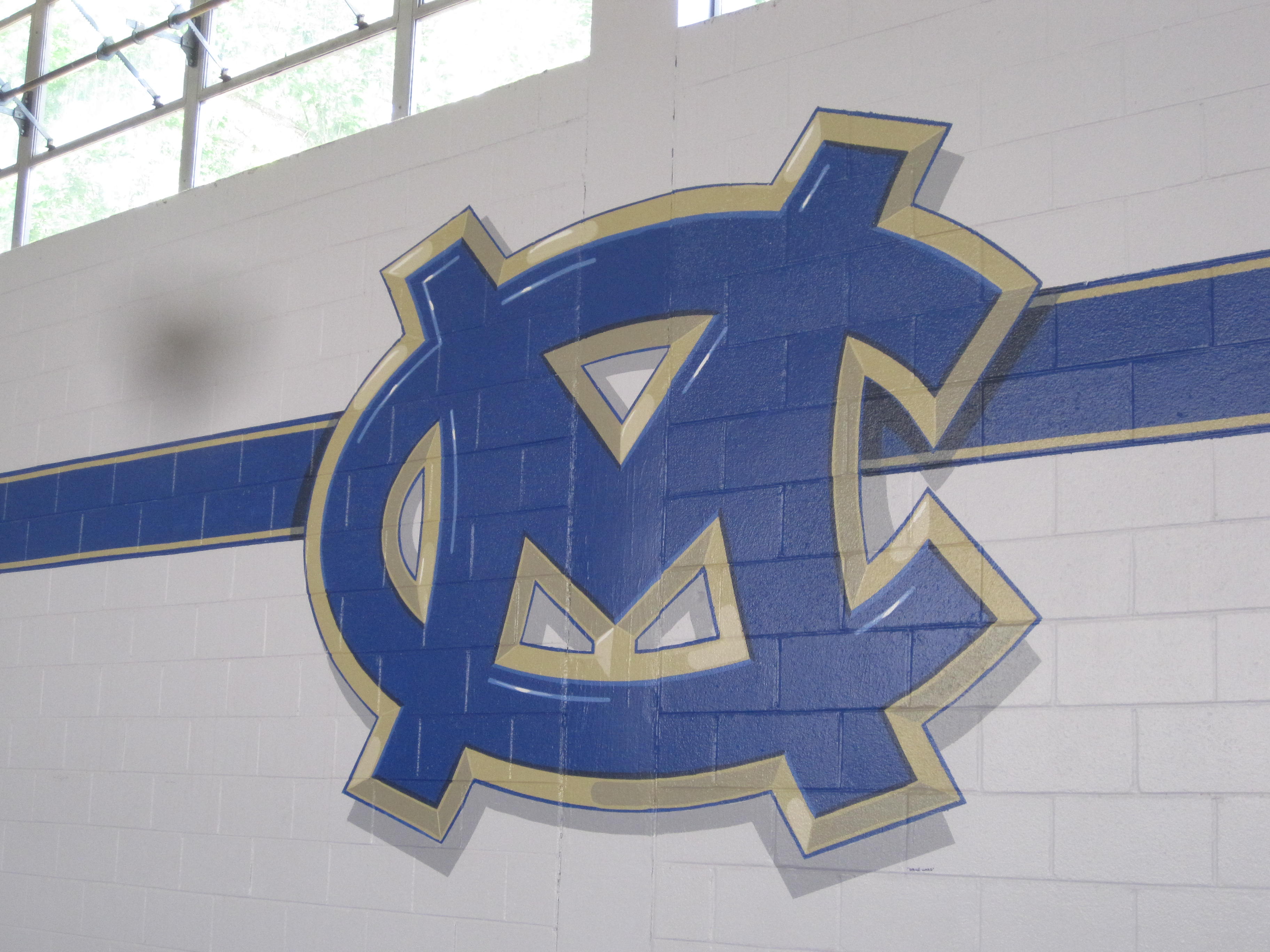

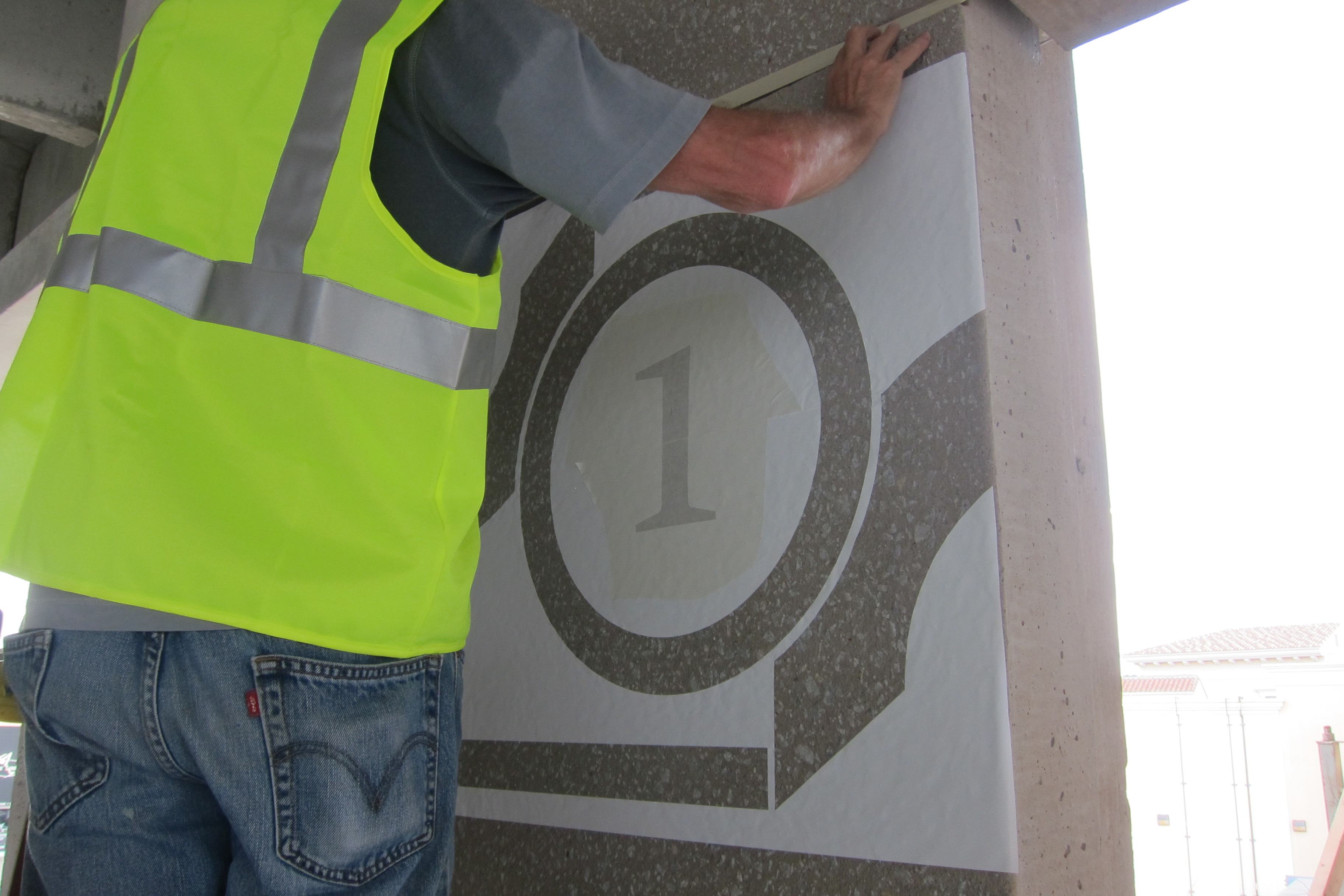

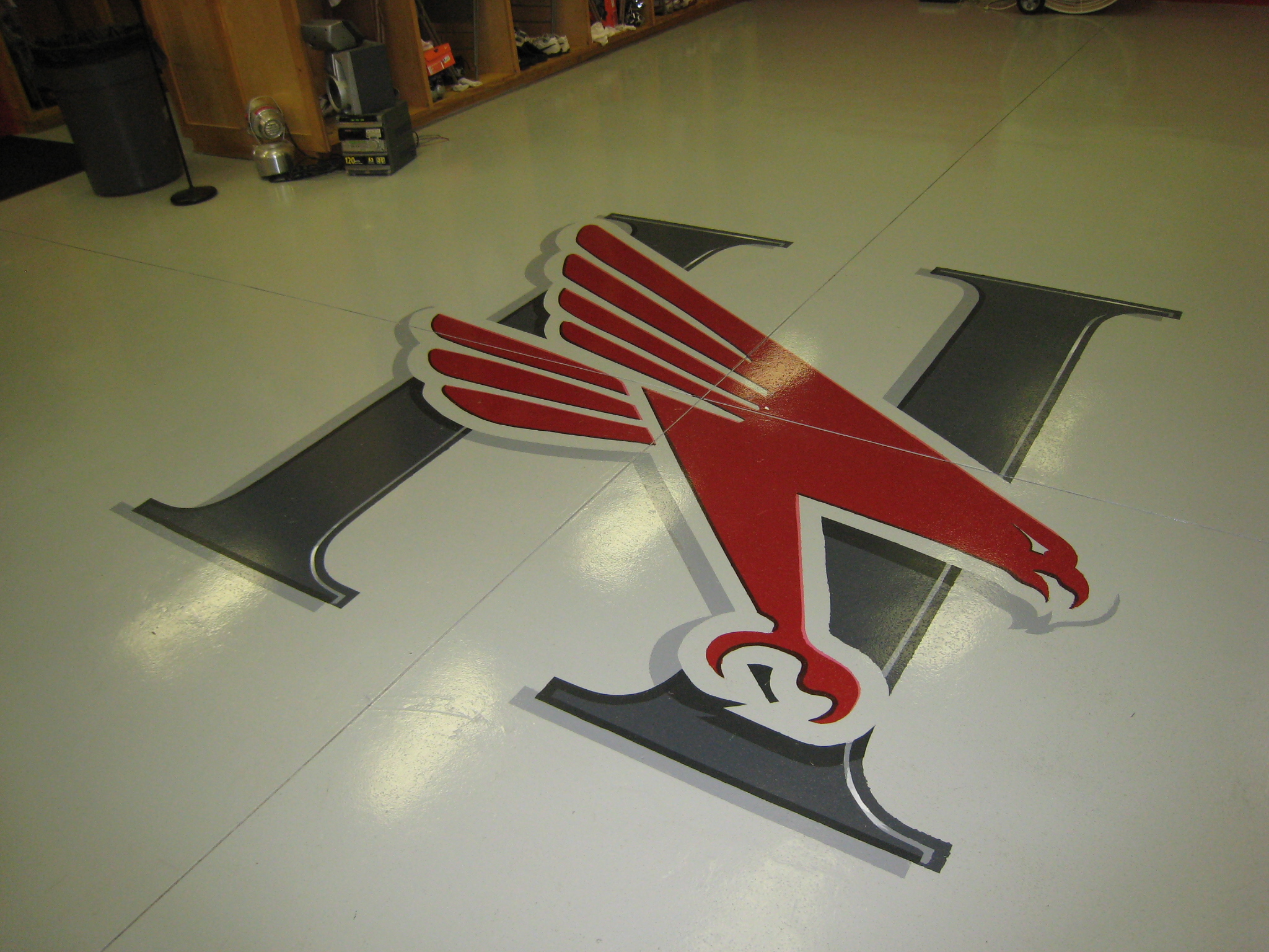

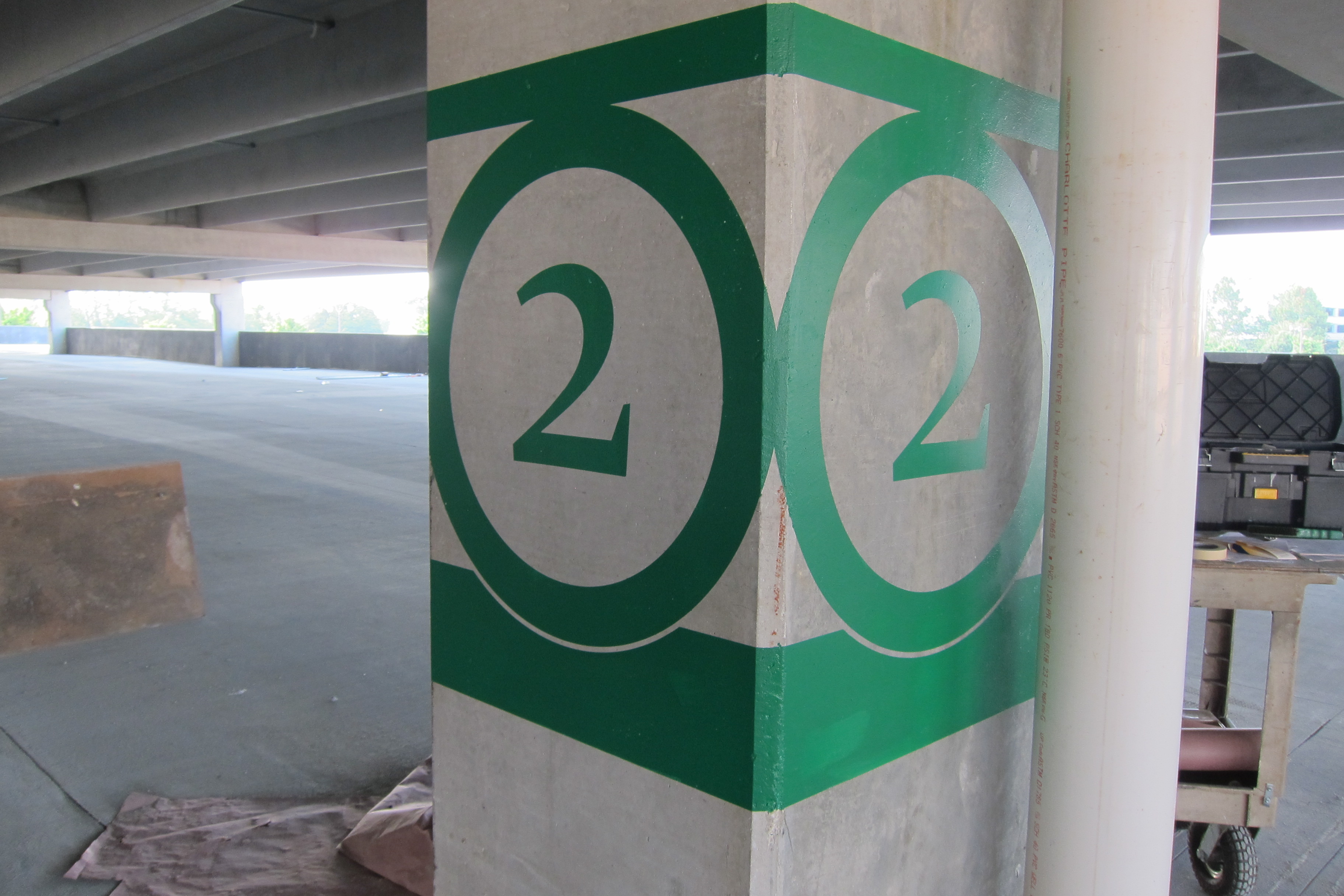

I do a lot of painting on bare concrete. I use BEHR satin enamel with primer. You dont need any sealer. In the pics on columns a mask was cut to get done quicker with work. Ive also done paper patterns. I use foam rollers and brushes depending on application. The MC was hand done with brushes. The school logo was a mask but freehand shaded
