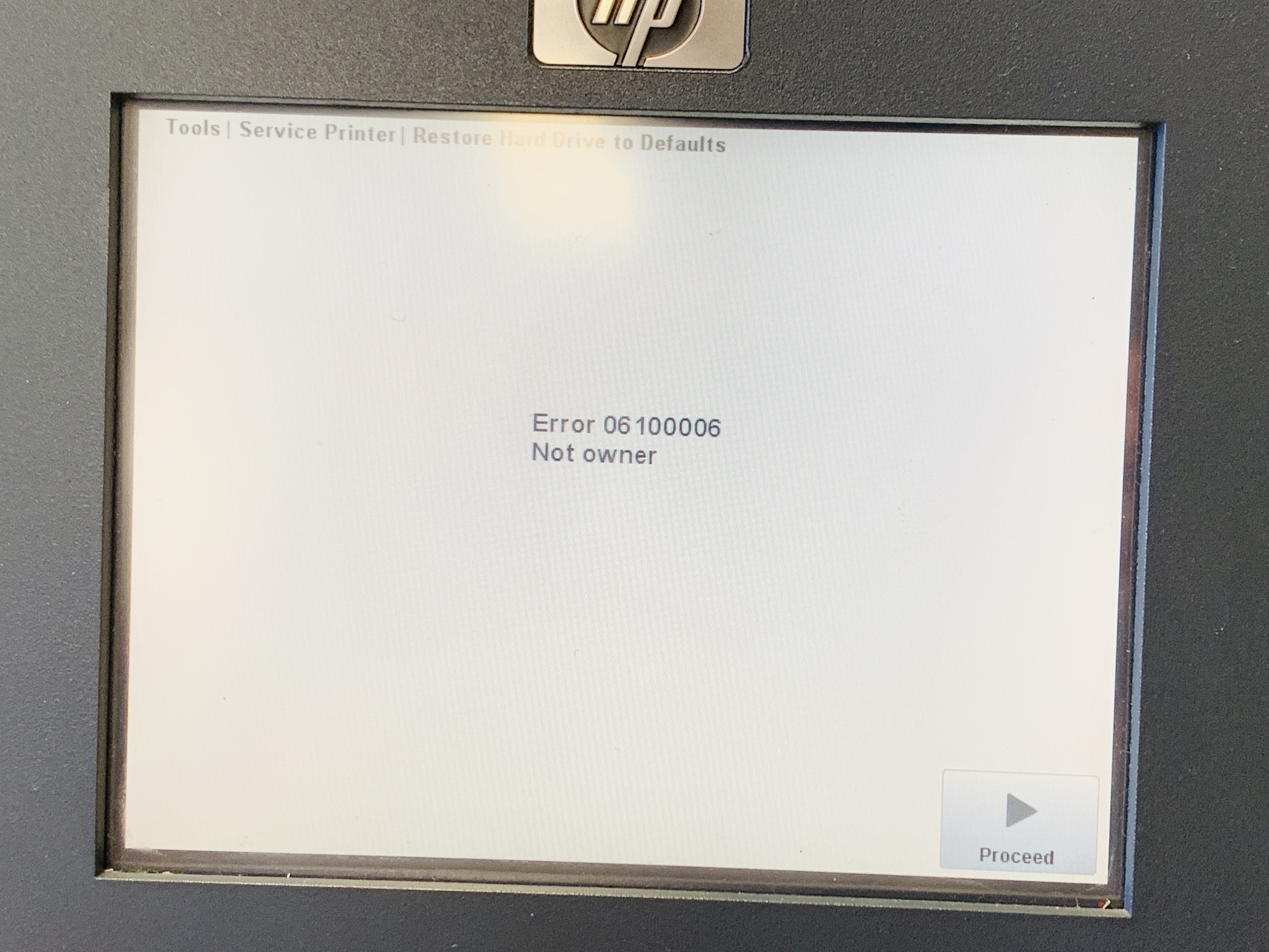

Having similar problems.
W-HD-4 - Job storage Disable
E-HD-5 - Failed to open job data file
Can see in logfile that its mounts Sata_0 to /Hdd and to /Jobs and I can see it creating files but when trying to access the directory or any file it doest find anything.
Filesystem checks out fine but SATA_0:b takes 111018ms to check in latest log, a couple of days ago it only took 1019ms. Both log files had the Harddrive errors.
A year ago I had problems with filesystem and restoring the HDD solved all problems. But when I try it now, like HP recommend it give me a new Error on display "Error 06100006 - Not owner".
Can´t find any info on that error other than 061xxxxx is HDD related.
Any help is appreciated.
Thanks
/J

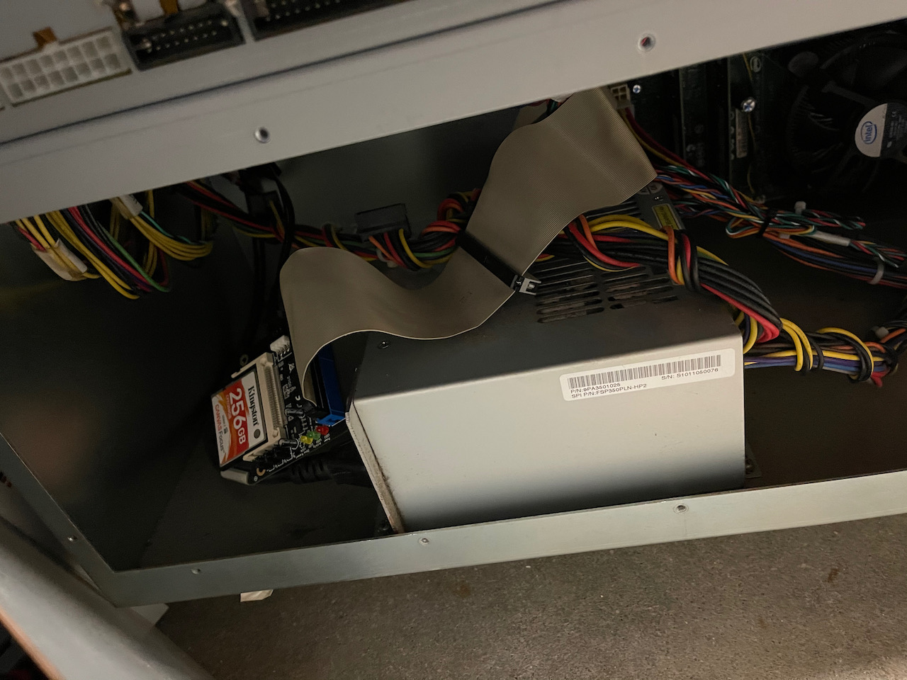

Nate Stone
We've had no issues since upgrading to a flash drive and an IDE-to-CompactFlash adapter. Since we used "dd" to copy the binary information of the drive directly, the system basically thinks it's still running the same IDE drive. That said, we did not expand the partition or change any sizes. So, the disk has the same sizing as the original disk (160GB even though the drive itself could store 256GB).
I can't guarantee it will work for anyone else and need to point out that you would certainly void any warranty if you do what we did. However, through one day, it's working for us. For the more conservative operators, you may want to wait a few days to hear if our good fortune continues. That said, I've done this a few times before on old manufacturing hardware and have never had a problem.
We used this adapter:
https://www.amazon.com/gp/product/B0026OYEEQ/ref=ppx_yo_dt_b_asin_title_o02_s00?ie=UTF8&psc=1
and this CF disk:
https://www.amazon.com/gp/product/B07MNB3W2J/ref=ppx_yo_dt_b_asin_title_o02_s00?ie=UTF8&psc=1
Then, we did a block-by-block copy of the source image:
sudo dd if=[DISK_OR_IMAGE_TO COPY] of=[/dev/THE_DISK_OR_IMAGE_TO_WRITE_TO] bs=1m conv=noerror,sync
If you are unfamiliar with 'dd' on Linux or Mac, there is a lot of documentation out there, but I am happy to help if needed. The key is to know which direction you are copying and arranging 'of' and 'if' correctly ('of' = output file, 'if' = input file).
For us we used an IDE-to-USB adapter to clone the original 160GB disk and then we wrote the image out to the 256GB disk using the above command.
We have a working image, so please send a private message if you'd like the link to download a copy. I'd rather not post a link openly to such a large file.
Good luck.
Here's a photo of our super-hacky yet awesome repair:
