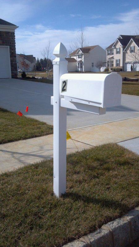

Has anyone tried the pvc material that is used for mailboxes and yard arm signs? If so how does cost compare?
