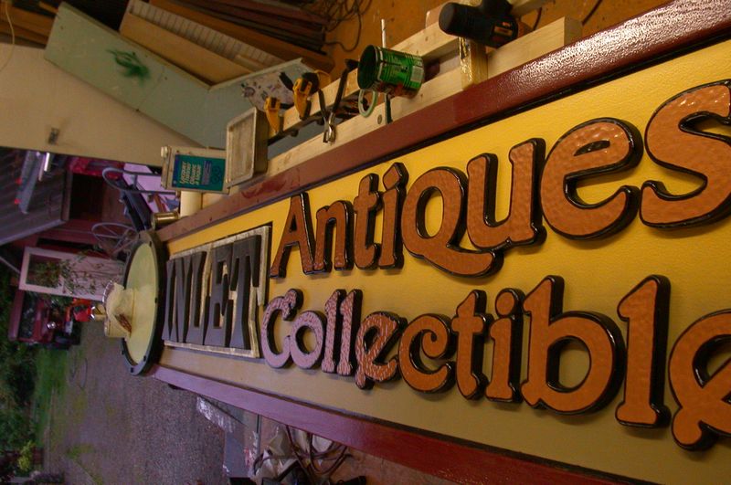

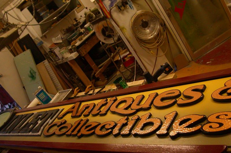

A while back I made these letters from mdo, distressed 'em with a ball peen hammer then painted them with copper HammerRite bumper paint. They look pretty convincing out in the sunlight.

SARDOCS... THAT IS AMAZING!!!
& to think you could do that on MDO... I wanna try that now!!
sardocs
We've done it to a quite a few different projects. It's a nice quick way to get a texture. I usually buy prepainted mdo, dimple it up, then give it a couple final coats. We use this technique on cedar signs also.
