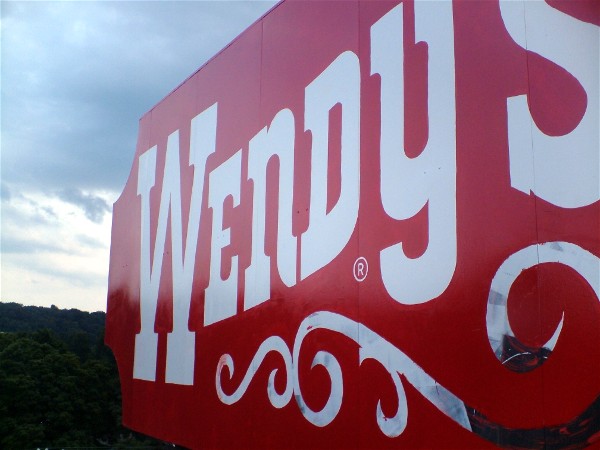

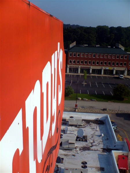

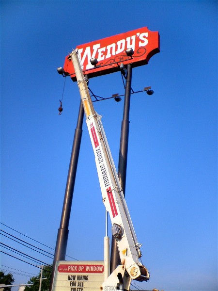

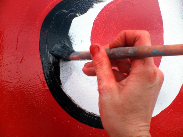

It took me 16 hours to do a double-sided 10'x20' metal sign.
I was in a lift.
First I scrubbed it, then primed it, then painted.
I estimated 24 hours but my brother, who was running the lift, rushed me like crazy.
Love....Jill
