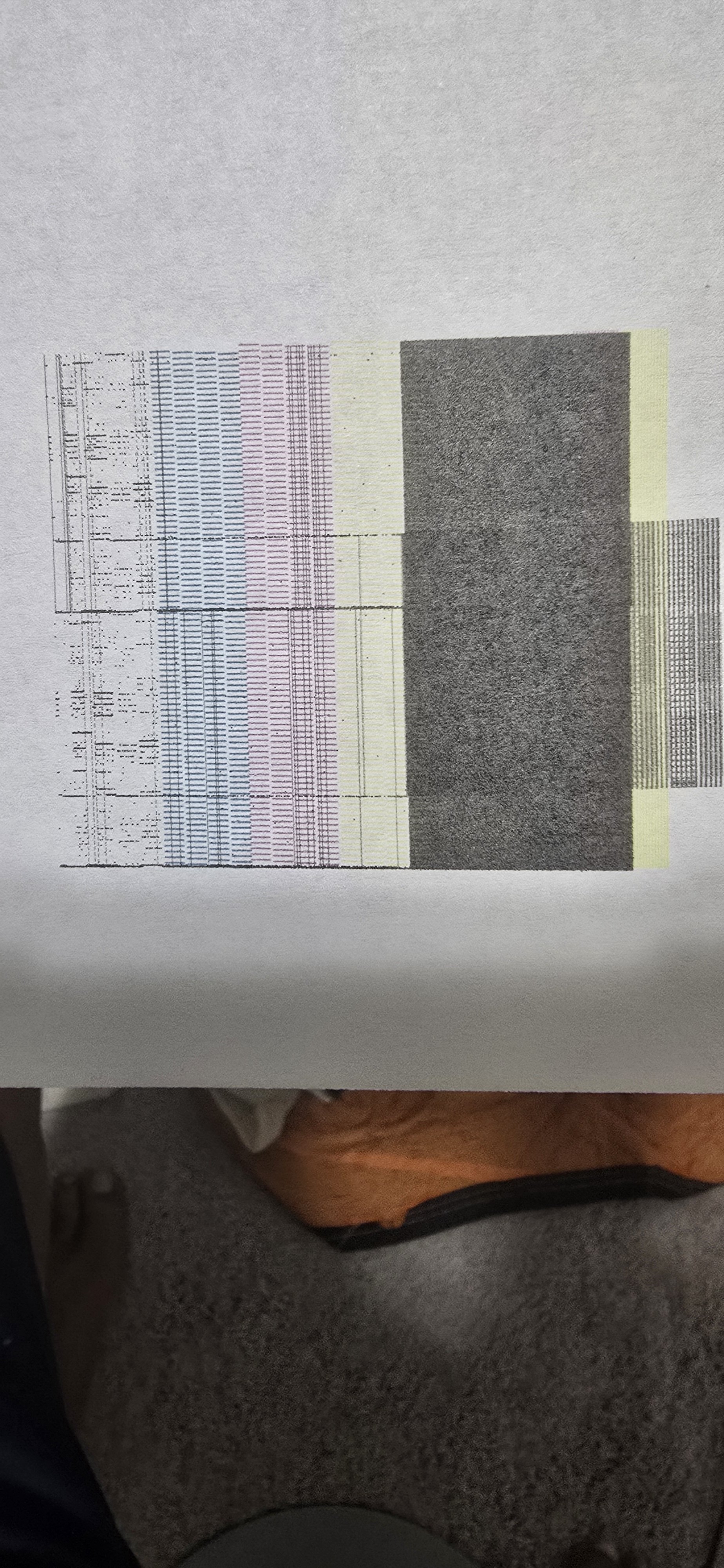

You have an electronic issue on the black channel (not the black head itself), this is not a printhead issue. It could be the carriage board, but more likely the mainboard. Did you verify the ribbon cable I pointed to is in straight? As always, with the printer unplugged for 15 minutes, verify both of those big ribbons are OK by pulling them out of their connectors, check the traces and carefully plug them back in. You can also put the head cables back in their proper locations, as we have verified this is a black channel signal issue. Then do another nozzle test and post the results.

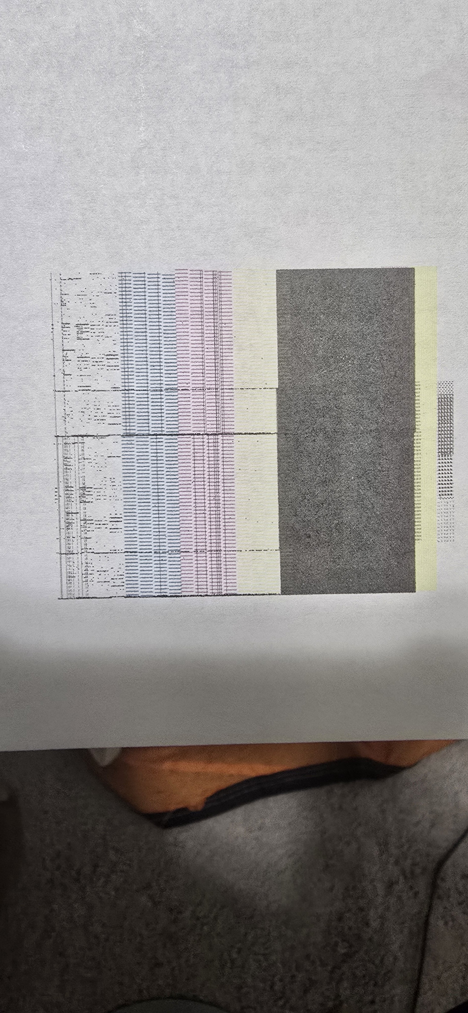

So these results are clear to you, what you have done is to drive the K/C head with the M/Y signals and the M/Y head with the K/C signals. Since the problem moved, it's a black channel signal issue, not an issue with the head itself.
Lightbulb88
After power down and removing of the large ribbons, and putting the printhead ribbons back into place. The machine did a cleaning and afterwards I did a test print. Nothing printed, all colors gone.

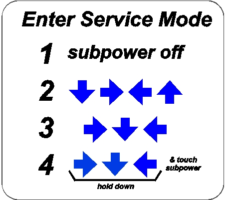

Hello Jim. I can't seem to get in service mode. Im trying to get to the head rank, I changed the head and dont remember if I put in the new head rank. I got locked out of the service mode when all the started to happen. I may need to put the head rank number in ..
Jim Hancock
Old School Technician
Here you go. Do I understand you put in a new head for the black? Did that fix the problem?

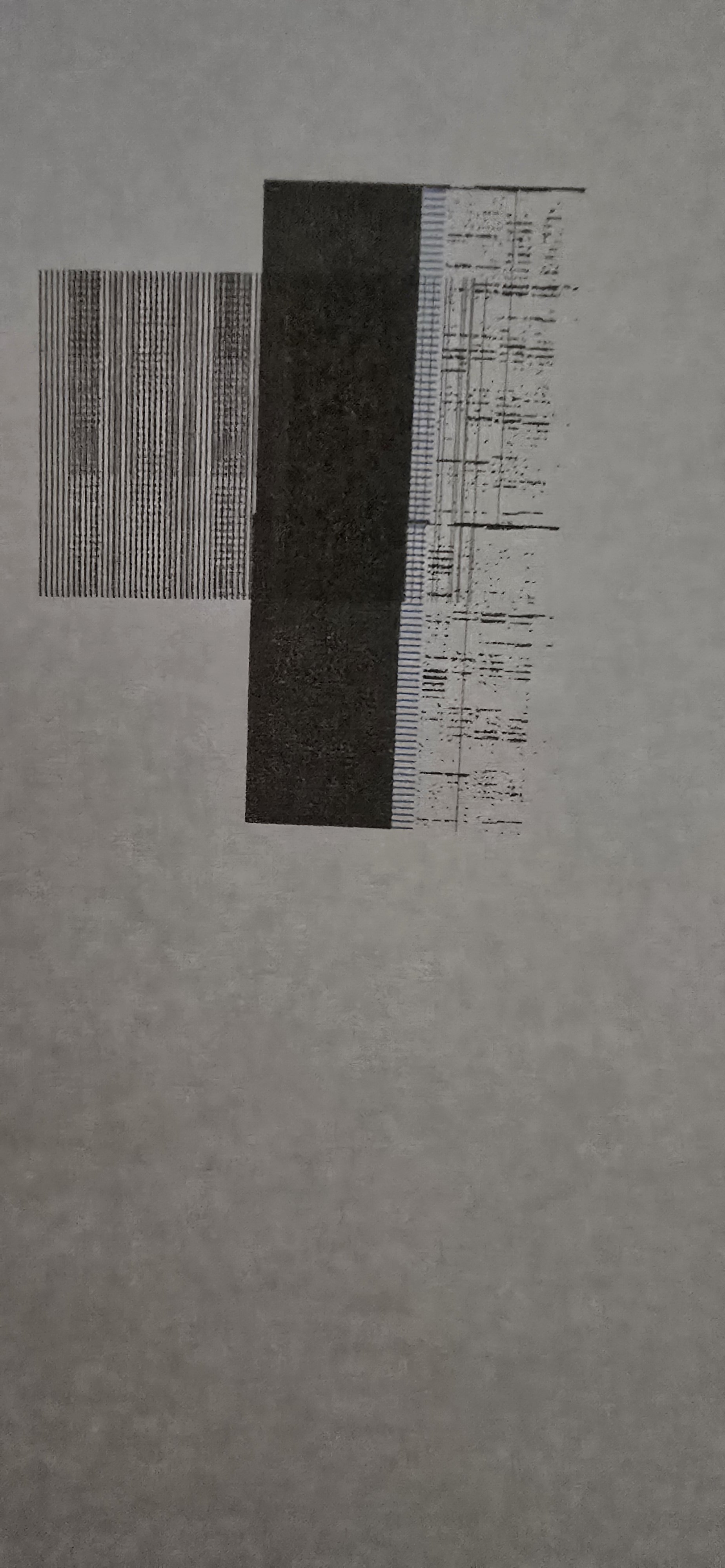

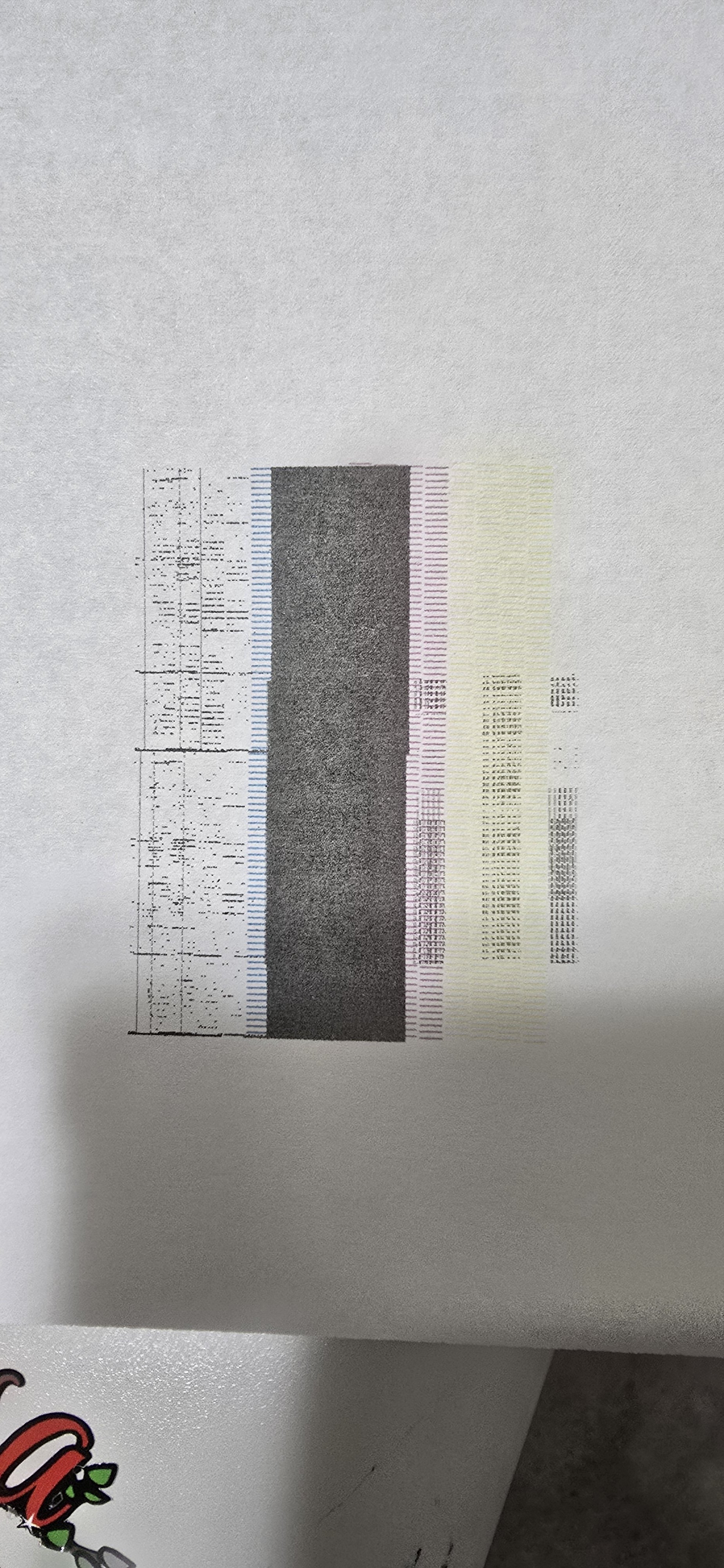

At the beginning before the black went out, had to change the manifold because the black ripple broke off. I replaced the manifold and the black did not work. I ordered anew print head with the manifold already on it, I may have been locked out of the service mode before I was able to put in the head rank. All of the trouble started after replacing the manifold.
Lightbulb88
I did a couple of medium cleanings and did a test print after each cleanings

Jim Hancock
My conclusion is you have a mainboard issue. Reach out to Damon and see if he can help. If not, I may have a source for a used mainboard.
