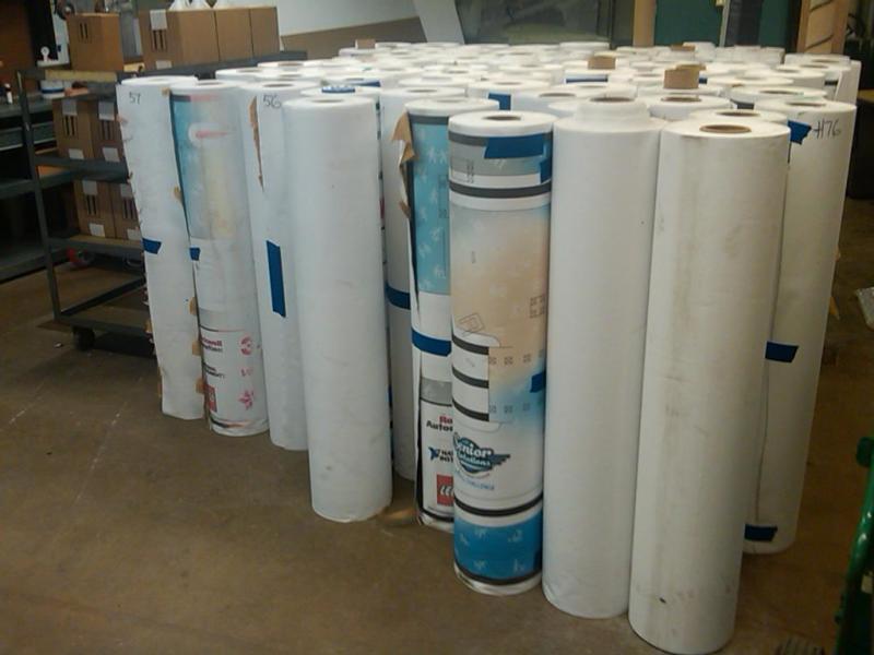

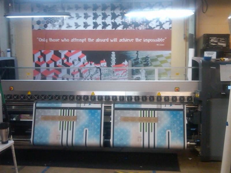

Production running pretty smooth. About 120 rolls into it. Then Tuesday it happened we went down HARD.. No one had any idea what the problem was.
Machine keep shutting off and would not print in registered at all would not allow us to calibrate or anything.. No sweat we will continue running on our backup LX. No luck there either since it was backed up running backlits for a national Vonage rollout campaign that had no wiggle room in deadline and 20 hours to finish and make the deadline. Since we have taken our LightJet out of productin a few months ago we print all backlits on a LX.
Turns out the entire encoder assembly and servo engine decided to call it quits. We had to rebuild the encoder assembly and replace servo engine. HP specialist was here Wed AM to make sure machine was stable. All is good now...
Found out yesterday someone had a lightly used LX600 for sale at pennies on the dollar and had to sell it. No brainer there so an LX600 will be here next week.
I still have major reservations if the LX850 dedicated to this project will survive without major issues. I must say HP support and the Latex specialist were on point which was a pleasant surprise.
