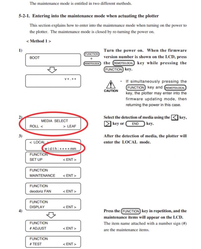

Tryin' to bring back to life my old mimaki JV3 160S, after logical changings: print heads... dumpers...
booting the printer on MAINTENANCE MODE... it goes directly on LOCAL... without passing through SELECT MEDIA (ROLL or LEAF)... and than... on display of LOCAL... without indicate the WIDTH line text.
Goin' on... i have not the possibility to run any kind of test draw... or adjusting operations!

Thnaks Vinylman - as i said... In normal mode... the printer boots in the same way... in normal working mode... and the display don't show me the second normal step... SELECT MEDIA...
