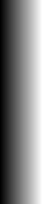

Run a full height (11.5") spot color gradient like the attached - should show any blown pixels
I use a similar setup, except it is a solid fill, 11.8" x 3", for a first print after turning my Edge on. It serves to distribute the heat evenly in the printhead and eliminates the occurrence of any pinholes or dropouts in the prints that follow.

ah so thats the initial 'each day' print? that makes sense.
The gradient test is for checking dead pixels, correct?

The best way to check for bad pixels is to print a 70% solid box of Colbalt blue, I know at least up to a few years ago that was how Gerber checked the print head. If it.s bad you’ll see what resembles rail road tracks.
